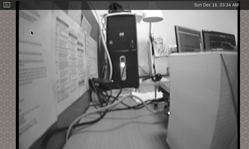

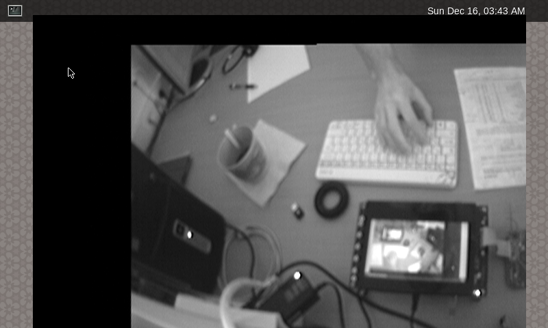

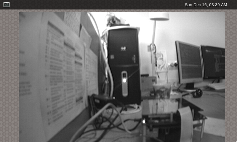

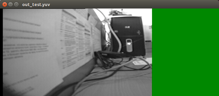

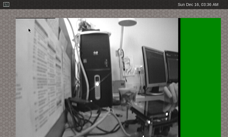

Hello, I am using the Linux Processor SDK for AM57x v05.02.00.10
I have two questions on the work of vip + tvp5150 in the External Sync. mode and Embedded Sync. aka BT.656 mode

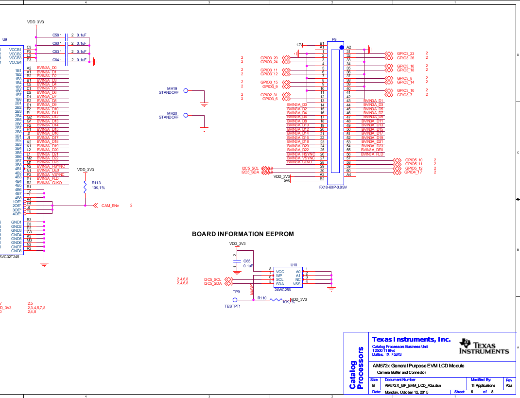

I connected the TVP5150 to the P9 connector of the TMDSEVM572X kit. See the diagram.
TVP connects to AM5728 as follows:
tvp5150 (yout0) <=> am5728 (vin3a_d0)
tvp5150 (yout1) <=> am5728 (vin3a_d1)
tvp5150 (yout2) <=> am5728 (vin3a_d2)
tvp5150 (yout3) <=> am5728 (vin3a_d3)
tvp5150 (yout4) <=> am5728 (vin3a_d4)
tvp5150 (yout5) <=> am5728 (vin3a_d5)
tvp5150 (yout6) <=> am5728 (vin3a_d6)
tvp5150 (yout7) <=> am5728 (vin3a_d7)
tvp5150 (avid) <=> am5728 (vin3a_de0)
tvp5150 (fid) <=> am5728 (vin3a_fld)
tvp5150 (hsync) <=> am5728 (vin3a_hsync)
tvp5150 (vsync) <=> am5728 (vin3a_vsync)
tvp5150 (pclk / sclk) <=> am5728 (vin3a_clko)

Situation one (for the case of external synchronization):
A1. I created the cam-tvp5150.dtso file
A2. Adapted drivers:
tvp5150 for debug = 2
ti_vip.ko (vip.c): debug = 3
vip.cvip.c
tvp5150.c

A5. Recorded video:
yavta -c10 -fYUYV -Fout_test.yuv -s720x288 / dev / video1
log_after_yavta.log
root@am57xx-evm:~# yavta -c10 -fUYVY -Fout_test.yuv -s720x288 /dev/video1 Device /dev/video1 opened. Device `vip' on `platform:vip2:vin3a:stream0' is a video output (without mplanes) device. Video format set: UYVY (59565955) 720x288 (stride 1440) field none buffer size 414720 Video format: UYVY (59565955) 720x288 (stride 1440) field none buffer size 414720 8 buffers requested. length: 414720 offset: 0 timestamp type/source: mono/EoF Buffer 0/0 mapped at address 0xb6e26000. length: 414720 offset: 417792 timestamp type/source: mono/EoF Buffer 1/0 mapped at address 0xb6dc0000. length: 414720 offset: 835584 timestamp type/source: mono/EoF Buffer 2/0 mapped at address 0xb6d5a000. length: 414720 offset: 1253376 timestamp type/source: mono/EoF Buffer 3/0 mapped at address 0xb6cf4000. length: 414720 offset: 1671168 timestamp type/source: mono/EoF Buffer 4/0 mapped at address 0xb6c8e000. length: 414720 offset: 2088960 timestamp type/source: mono/EoF Buffer 5/0 mapped at address 0xb6c28000. length: 414720 offset: 2506752 timestamp type/source: mono/EoF Buffer 6/0 mapped at address 0xb6bc2000. length: 414720 offset: 2924544 timestamp type/source: mono/EoF Buffer 7/0 mapped at address 0xb6b5c000. ^C root@am57xx-evm:~# dmesg [ 328.311529] vin3a-0: vip_open [ 328.311554] tvp5150 4-005d: width = 720, height = 288 [ 328.311562] vin3a: vip_init_port: g_mbus_fmt subdev mbus_code: 2006 fourcc:UYVY size: 720x288 [ 328.311574] vin3a: calc_format_size: fourcc:UYVY size: 720x288 bpl:1440 img_size:414720 [ 328.311582] vin3a-0: init_stream fourcc:UYVY size: 720x288 bpl:1440 img_size:414720 [ 328.311587] vin3a-0: init_stream vpdma data type: 0x27 [ 328.311595] vin3a-0: vip_init_stream: stream instance 0xc0bb2874ed237000 [ 328.312180] vin3a-0: s_fmt input fourcc:UYVY size: 720x288 bpl:0 img_size:0 [ 328.312188] vin3a-0: try_fmt fourcc:UYVY size: 720x288 [ 328.312197] vin3a-0: try_fmt loop:0 fourcc:UYVY size: 720x288 [ 328.312203] vin3a-0: try_fmt loop:0 found new larger: 720x288 [ 328.312209] vin3a-0: try_fmt loop:0 found at least larger: 720x288 [ 328.312214] vin3a-0: try_fmt loop:0 found new best: 720x288 [ 328.312220] vin3a-0: try_fmt loop:0 found direct match: 720x288 [ 328.312227] vin3a: calc_format_size: fourcc:UYVY size: 720x288 bpl:1440 img_size:414720 [ 328.312233] vin3a-0: s_fmt try_fmt fourcc:UYVY size: 720x288 bpl:1440 img_size:414720 [ 328.312240] vin3a-0: s_fmt fourcc:UYVY size: 720x288 bpl:1440 img_size:414720 [ 328.312246] vin3a-0: s_fmt pix_to_mbus mbus_code: 2006 size: 720x288 [ 328.312254] tvp5150 4-005d: width = 720, height = 288 [ 328.312261] vin3a-0: s_fmt subdev fmt mbus_code: 2006 size: 720x288 [ 328.312266] vin3a-0: s_fmt vpdma data type: 0x27 [ 328.312490] vin3a-0: g_fmt fourcc:UYVY code: 2006 size: 720x288 bpl:1440 img_size:414720 [ 328.312496] vin3a-0: g_fmt vpdma data type: 0x27 [ 328.312706] vin3a-0: get 8 buffer(s) of size 414720 each. [ 328.319513] vin3: vip_set_slice_path: [ 328.319523] vin3: vip_set_slice_path: DATA_PATH_SELECT(0000010C): 80008000 [ 328.319528] vin3: vip_set_slice_path: [ 328.319534] vin3: vip_set_slice_path: DATA_PATH_SELECT(0000010C): 40008000 [ 328.319811] vin3: vip_setup_parser: EMBEDDED_SYNC_SINGLE_YUV422 [ 328.319816] vin3: vip_setup_parser: EMBEDDED_SYNC_LINE_MULTIPLEXED_YUV422 [ 328.319821] vin3: vip_setup_parser: VIP_PIXCLK_EDGE_POLARITY=0 [ 328.320119] tvp5150 4-005d: tvp5150: read 0x03 = 6b [ 328.320128] tvp5150 4-005d: tvp5150: writing 03 6b [ 328.320290] vin3a-0: vip_load_vpdma_list_fifo: start_dma vb2 buf idx:0 [ 328.321418] vin3a-0: vip_load_vpdma_list_fifo: start_dma vb2 buf idx:1 [ 347.591677] vin3a-0: vip_release [ 347.591688] vin3a-0: vip_stop_streaming: [ 347.591697] vin3: vip_set_slice_path: [ 347.591705] vin3: vip_set_slice_path: DATA_PATH_SELECT(0000010C): 80008000 [ 347.591710] vin3: vip_set_slice_path: [ 347.591717] vin3: vip_set_slice_path: DATA_PATH_SELECT(0000010C): 40008000 [ 347.592014] tvp5150 4-005d: tvp5150: read 0x03 = 6b [ 347.592023] tvp5150 4-005d: tvp5150: writing 03 62 [ 347.592211] vin3a-0: Clear channel no: 38 [ 347.592797] vin3a-0: vip_release_stream: stream instance 0x00000008ed237000 [ 347.592804] vin3a: vip_release_port: port instance 0xeda3fe40ed208810 root@am57xx-evm:~# ------------------------------------------------------------------------------------------------- root@am57xx-evm:~# yavta -c10 -fYUYV -Fout_test.yuv -s720x288 /dev/video1 Device /dev/video1 opened. Device `vip' on `platform:vip2:vin3a:stream0' is a video output (without mplanes) device. Video format set: YUYV (56595559) 720x288 (stride 1440) field none buffer size 414720 Video format: YUYV (56595559) 720x288 (stride 1440) field none buffer size 414720 8 buffers requested. length: 414720 offset: 0 timestamp type/source: mono/EoF Buffer 0/0 mapped at address 0xb6ddb000. length: 414720 offset: 417792 timestamp type/source: mono/EoF Buffer 1/0 mapped at address 0xb6d75000. length: 414720 offset: 835584 timestamp type/source: mono/EoF Buffer 2/0 mapped at address 0xb6d0f000. length: 414720 offset: 1253376 timestamp type/source: mono/EoF Buffer 3/0 mapped at address 0xb6ca9000. length: 414720 offset: 1671168 timestamp type/source: mono/EoF Buffer 4/0 mapped at address 0xb6c43000. length: 414720 offset: 2088960 timestamp type/source: mono/EoF Buffer 5/0 mapped at address 0xb6bdd000. length: 414720 offset: 2506752 timestamp type/source: mono/EoF Buffer 6/0 mapped at address 0xb6b77000. length: 414720 offset: 2924544 timestamp type/source: mono/EoF Buffer 7/0 mapped at address 0xb6b11000. ^C root@am57xx-evm:~# dmesg [ 489.396883] vin3a-0: vip_open [ 489.396908] tvp5150 4-005d: width = 720, height = 288 [ 489.396917] vin3a: vip_init_port: g_mbus_fmt subdev mbus_code: 2006 fourcc:UYVY size: 720x288 [ 489.396929] vin3a: calc_format_size: fourcc:UYVY size: 720x288 bpl:1440 img_size:414720 [ 489.396936] vin3a-0: init_stream fourcc:UYVY size: 720x288 bpl:1440 img_size:414720 [ 489.396942] vin3a-0: init_stream vpdma data type: 0x27 [ 489.396950] vin3a-0: vip_init_stream: stream instance 0xc0bb2874ed237000 [ 489.397122] vin3a-0: s_fmt input fourcc:YUYV size: 720x288 bpl:0 img_size:0 [ 489.397129] vin3a-0: try_fmt fourcc:YUYV size: 720x288 [ 489.397138] vin3a-0: try_fmt loop:0 fourcc:YUYV size: 720x288 [ 489.397145] vin3a-0: try_fmt loop:0 found new larger: 720x288 [ 489.397152] vin3a-0: try_fmt loop:0 found at least larger: 720x288 [ 489.397159] vin3a-0: try_fmt loop:0 found new best: 720x288 [ 489.397167] vin3a-0: try_fmt loop:0 found direct match: 720x288 [ 489.397174] vin3a: calc_format_size: fourcc:YUYV size: 720x288 bpl:1440 img_size:414720 [ 489.397182] vin3a-0: s_fmt try_fmt fourcc:YUYV size: 720x288 bpl:1440 img_size:414720 [ 489.397190] vin3a-0: s_fmt fourcc:YUYV size: 720x288 bpl:1440 img_size:414720 [ 489.397196] vin3a-0: s_fmt pix_to_mbus mbus_code: 2006 size: 720x288 [ 489.397205] tvp5150 4-005d: width = 720, height = 288 [ 489.397211] vin3a-0: s_fmt subdev fmt mbus_code: 2006 size: 720x288 [ 489.397217] vin3a-0: s_fmt vpdma data type: 0x07 [ 489.397284] vin3a-0: g_fmt fourcc:YUYV code: 2006 size: 720x288 bpl:1440 img_size:414720 [ 489.397289] vin3a-0: g_fmt vpdma data type: 0x07 [ 489.397347] vin3a-0: get 8 buffer(s) of size 414720 each. [ 489.401221] vin3: vip_set_slice_path: [ 489.401231] vin3: vip_set_slice_path: DATA_PATH_SELECT(0000010C): 80008000 [ 489.401238] vin3: vip_set_slice_path: [ 489.401246] vin3: vip_set_slice_path: DATA_PATH_SELECT(0000010C): 40008000 [ 489.401523] vin3: vip_setup_parser: EMBEDDED_SYNC_SINGLE_YUV422 [ 489.401532] vin3: vip_setup_parser: EMBEDDED_SYNC_LINE_MULTIPLEXED_YUV422 [ 489.401537] vin3: vip_setup_parser: VIP_PIXCLK_EDGE_POLARITY=0 [ 489.401777] tvp5150 4-005d: tvp5150: read 0x03 = 62 [ 489.401788] tvp5150 4-005d: tvp5150: writing 03 6b [ 489.401930] vin3a-0: vip_load_vpdma_list_fifo: start_dma vb2 buf idx:0 [ 489.403063] vin3a-0: vip_load_vpdma_list_fifo: start_dma vb2 buf idx:1 [ 494.081846] vin3a-0: vip_release [ 494.081858] vin3a-0: vip_stop_streaming: [ 494.081868] vin3: vip_set_slice_path: [ 494.081877] vin3: vip_set_slice_path: DATA_PATH_SELECT(0000010C): 80008000 [ 494.081882] vin3: vip_set_slice_path: [ 494.081888] vin3: vip_set_slice_path: DATA_PATH_SELECT(0000010C): 40008000 [ 494.082126] tvp5150 4-005d: tvp5150: read 0x03 = 6b [ 494.082134] tvp5150 4-005d: tvp5150: writing 03 62 [ 494.082297] vin3a-0: Clear channel no: 38 [ 494.082863] vin3a-0: vip_release_stream: stream instance 0x00000008ed237000 [ 494.082871] vin3a: vip_release_port: port instance 0xeda133c0ed208810
out_test.yuv.tar.gzout_test.yuv.tar.gz
A6. Displayed image using gstreamer:
gst-launch-1.0 v4l2src device = / dev / video1 io-mode = 4! 'video / x-raw, format = (string) YUY2, width = (int) 720, height = (int) 288'! waylandsink use-drm = true
after_gst-launch-1.0.logafter_gst-launch-1.0.log
gst-launch-1.0.log
Setting pipeline to PAUSED ... Pipeline is live and does not need PREROLL ... Setting pipeline to PLAYING ... New clock: GstSystemClock handling interrupt. Interrupt: Stopping pipeline ... Execution ended after 0:00:09.098645294 Setting pipeline to PAUSED ... Setting pipeline to READY ... Setting pipeline to NULL ... Freeing pipeline ...
A7. The work of yavta and gstreamer led to the following result

The first question. How can I eliminate the image shift, ie remove the black bars on the left and on the top?
Situation two (for the case of Embedded Sync. aka BT.656):
