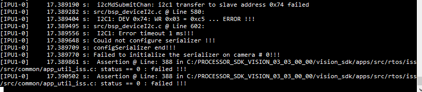

I try to use vision SDK demo.
the setup includes : TDA3x-evm,DS90UB96X-Q1EVM ,HDMI displayer and one AR0143-mars.
and I have measured that the power supply for AR0143 is 9V,
I enter the command as follows to try to run the case:
s---->2---->c----->5----->1
it raise a issue of configuring serializer. you can see the picture.
does someone know why?
