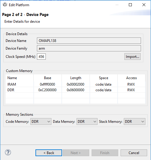

Hello, I'm a beginner and I'm using ftp in my platform and this work slow (slow transfer file). I have a problem with running the cache in OMAPL138. When I use a cache without mmu my program dies after a few seconds.
I'm using ti-processor-sdk-rtos-omapl138-lcdk-05.01.00.11 with:
-> bios_6_73_00_12
-> pdk_omapl138_1_0_6
My *.cfg file:

var Cache1  = xdc.useModule('ti.sysbios.family.arm.arm9.Cache');
var Mmu = xdc.useModule('ti.sysbios.family.arm.arm9.Mmu');
/* Enable the cache                                                           */
Cache1.enableCache = false;
/* Enable the MMU (Required for L1 data caching)                              */
Mmu.enableMMU = false;
/* Enable the MMU (Required for L1/L2 caching)                              */
Platform package:
When I add to *.cfg file code with example:
Cache1.enableCache = true;
Mmu.enableMMU = true;
 *              MMU Configuration              *

Do you have any instructions to run the cache?
What am I doing wrong? Where is the problem?

    I'm working on an old project and it seems to me that MMU for DDR is nowhere to be made.
    What should I do?
    Where can I find more information about this topic?

  • Thank you Sahin for the answer. I have read the document and when I want use cache for my entire DDR memory (screenshot ROV Object View below)
    I have a same problem:

    Where can I look for a solution? I have no idea what I'm doing wrong...
