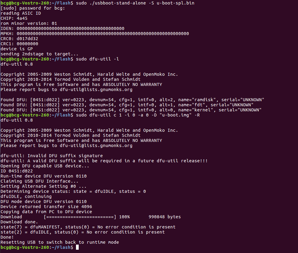

I am using EVM TMDXIDK5718. I  wanted to try out usbboot. For this purpose I have modified USB1 from host to device mode.
I have configured sysboot pins to enable usbboot.
I have tried the steps provided in link
I  could execute till following command "'host$ sudo usbboot-stand-alone -S spl/u-boot-spl.bin""
Here in I get the following response on minicom
U-Boot SPL 2018.01-00558-gca1e85ecb5-dirty (Feb 18 2019 - 14:29:39)
DRA722-GP ES2.0
Trying to boot from DFU
Using default environment
port 0 can't be used as device
board usb init failed

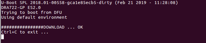

AS i understand i could dump and execute usbspl to AM5718. But from there on these is no response.
What  is the issue?? Why is usb init as device failing?? Pls respond
  • Referred the following thread https://e2e.ti.com/support/processors/f/791/t/701775?Linux-AM5728-DFU-support-on-IDK.  Included the patch as suggested.
    I guess I was able to download u-boot Image but could not execute uboot image .
    Pls let me know how to proceed further
    Attaching sceen shots.... both host prints and mincom prints captures....
  • Hi Rakesh,
    The Processor SDK v5.x U-Boot doesn't support DFU boot for AM57x devices. Please follow the e2e thread linked below (sorry it is a long thread) to understand how to modify U-Boot use to DFU boot on AM57x. Mainly there are two patches needed.
    1. Modify USB1 from host to device mode;
    2. Fix UBoot so that SPL can locate the downloaded UBoot image.
    e2e.ti.com/.../730514
    Please also follow the training video linked below for how to use DFU Boot.
    training.ti.com/am57x-dra7x-dfu-boot-mode-with-linux-host

    ""U-Boot SPL 2018.01-00558-gca1e85ecb5-dirty (Feb 21 2019 - 11:28:08)
    DRA722-GP ES2.0
    ################DOWNLOAD ... OK""
    Ctrl+C to exit ...
    I guess as u suggested still SPL cannot locate u-boot img.... I am attaching the screen shots of minicom & USB host print....and files patched
  • Rakesh Muralidharan said:
    TI_Files.rar Attachments
    I checked am57xx_evm.h you attached, but it doesn't have patch 0002. Please ensure you applied both patches properly.
  • I attached both patches here for your reference.
