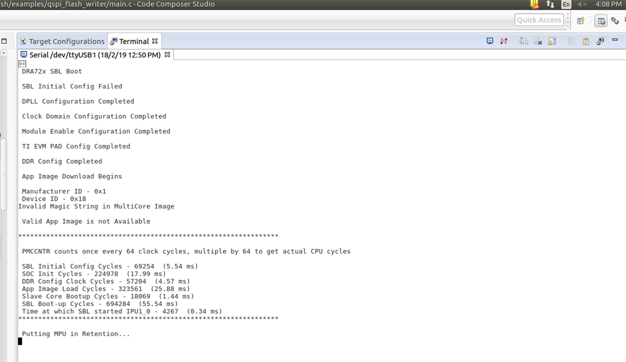

By following above guide and with the use of TDA2XX board, we try to generate and flash SBL & Application images into QSPI flash. In the end there is NO complete application loading.
This is the snapshot of Terminal prints after SBL TIIMAGE file is loaded.
- can you point out why "SBL Initial Config Failed" comes and how to overcome this?
Below are the prints in Terminal window after loading the APP muticore image binary - FYI, MPU_CPU1_ID (value = 1) was used to generated this.
DRA72x SBL Boot

    You can follow the below sequence to debug:
    1. Can you set the board in debug mode as per the user guide.
    2. Use CCS to load SBL (built in debug mode) and single step to identify the failure.

    Yes your above two comments based steps were already taken care... I believe because of this only such Terminal prints (one after SBL alone loaded stage and next after App image loading) are shown in boot sequence.
    My queries :
    1) is the "SBL init config failed" [gets printed as part of the SBL boot sequence] an issue for an incomplete App boot-up ?

    You have misinterpreted my comment.
    I would like to re-iterate that all the information you need for SBL is already there in user guide.
    It seems that you are trying to run TDA2E SBL on TDA2 board in above case. Same is mentioned in SBL user guide chapter 2.

    No the option (as per Chapter 2) to select for "evmDRA72x or TDA2xx" is yet to be tried and whole steps are yet to be checked.

    A15 is master for TDA2x device and flash writer should be run from M4 as given in user guide.
    SBL elf is not loaded. It is converted to tiimage which is loaded by SBL.
    Device/Core Id configuration and usage is documented in SBL user guide.
    You can also see various scripts under <pdk>\packages\ti\boot\sbl_auto\tools folder.

    Hi Rishabh,
    Though the above two replies/queries are still open (in our perspective), for now we are able to flash & boot the Mailbox Multicore Example Application.. based on some of the inputs from you. So this thread can be closed and for any queries related to above two reply posts, we shall open new post, particularly based on our own customized application boot/flash status. Thanks for the support rendered !
