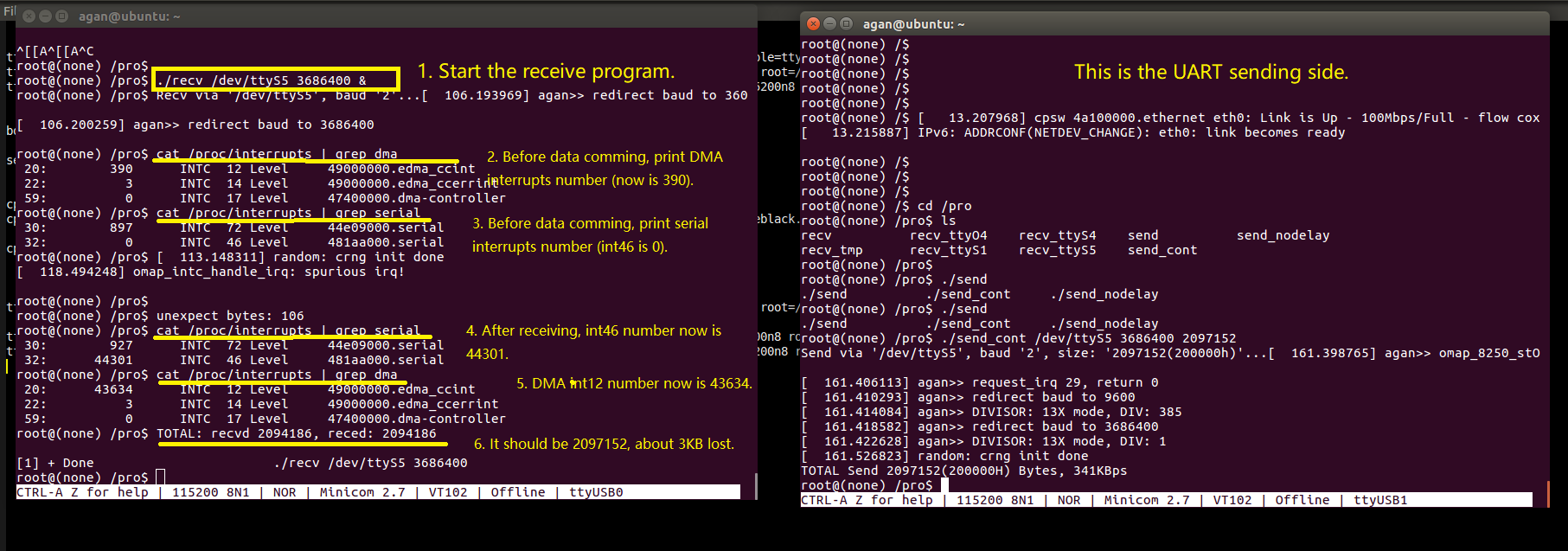

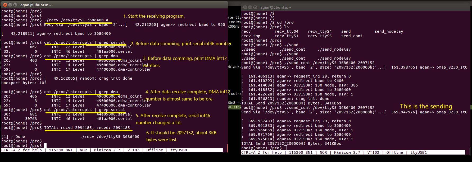

    Actually, I made the test with UART5, which interrupt number is 46.  The DMA is enabled or disabled by editting dts file.
    This is the screenshot when UART5 receiving without DMA. You can see that the serial interrupt raised about 30000 times, but DMA interrupt almost keep still.
    This is the screenshot when UART5 receiving with DMA. You can see serial interrupt raised 44000 times, more than that of the case without DMA. Also 43000 times of DMA interrupts were raised.

  • From the upper screenshots, you will see that uart receiving with dma has more interrupts raised than that without dma.
