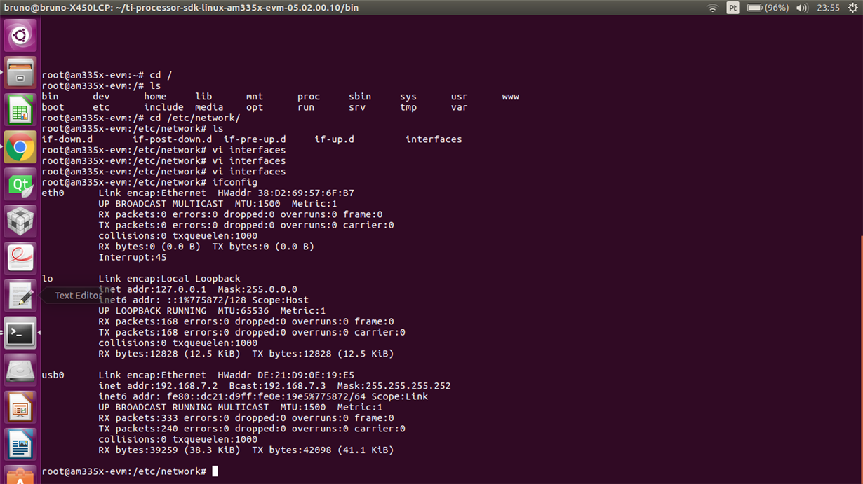

In the target, my /etc/network/interfaces and ifconfig log look like this:
# /etc/network/interfaces -- configuration file for ifup(8), ifdown(8)
# The loopback interface
auto lo
iface lo inet loopback
# Wireless interfaces
iface wlan0 inet dhcp
	wireless_mode managed
	wireless_essid any
	wpa-driver wext
	wpa-conf /etc/wpa_supplicant.conf
iface tiwlan0 inet dhcp
	wireless_essid any
iface atml0 inet dhcp
# Wired or wireless interfaces
auto eth0
iface eth0 inet dhcp
        pre-up /bin/grep -v -e "ip=[0-9]\+\.[0-9]\+\.[0-9]\+\.[0-9]\+" /proc/cmdline > /dev/null
        udhcpc_opts -R -b
iface eth1 inet dhcp
# Ethernet/RNDIS gadget (g_ether)
# ... or on host side, usbnet and random hwaddr
auto usb0
iface usb0 inet static
        address 192.168.7.2
        netmask 255.255.255.252
	network 192.168.7.0
	gateway 192.168.7.1
# Bluetooth networking
iface bnep0 inet dhcp
ifconfig_target.log

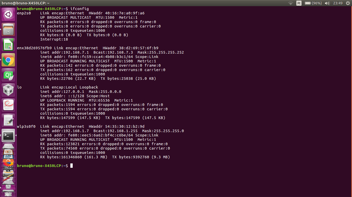

In the host, my  /etc/network/interfaces and ifconfig log look like this:
# interfaces(5) file used by ifup(8) and ifdown(8)
auto lo
ifconfig_host.log
I'm sorry to attach the ifconfig logs as images, but it is the only choice I got, because I'd have to reflash the image again to actually do a successful ifconfig &> ifconfig.log at the target and at the host. Each reflashing process takes up to 30 minutes. So, it is really annoying.
Any help would be greatly appreciated.
