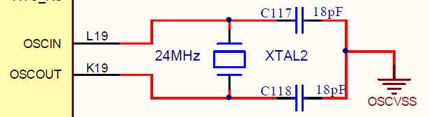

We are getting issues in some boards with DSP running at 456MHz with core voltage 1.3V. Issue is related to, power-up and crystal/oscillator.
On working board, DSP (TMS320C6746EZWT3)  is running at 300MHz with core voltage 1.2V
Clock source is like this.
We never had any problem with this board.
Now, on a new board, DSP (TMS320C6746EZWT4) is expected to run at 456MHz with core voltage 1.3V
It doesn’t boot with every power on. It is random. Sometimes boots up, sometimes doesn’t.
Some boards never boot.
When it doesn’t boot, pressing reset button to processor makes the DSP boot and run.
Same board works fine when we parallel two 18pF caps on each leg. That means 36pF on each leg. Each power On, it boots fine.

    It is not obvious why a single 36pF capacitor doesn’t operate the same way as two 18pF capacitors connected in parallel.  Hopefully you are using ceramic NPO capacitors for this application.  NPO capacitors are readily available in these values and are stable across voltage and temperature with minimum aging effects.  High density multi-layer ceramic capacitors are not stable across voltage and temperature.
    Can you share the manufacture and part number information of crystal and capacitors being used for this testing?
    Additionally this may not help you if you have an existing board design, but in our device schematic checklist we recommend a resistor in series Rs.
    We have seen some issues like this from time to time with customers. Mostly system or crystal dependent.
    You can refer to
    http://www.ti.com/lit/an/sprack9/sprack9.pdf
    section 2.3.4 on Rbias and Rs resistors
    Here is a similar sounding post that was fixed using series resistor

    Crystal P/N#: ABM3-24.000MHZ-D2Y-T (24MHz; 20ppm; ESR:30 Ohm) from Abracon
    Capacitor P/N#: GRM1885C1H330JA01D (33pF, 50V NPO) from Murata
    Series Resistor option is not yet tried

  • May I request you to recommend value of series resistor? Looking at the PCBA, It is difficult to fit series resistor. So we have plan to replace Crystal with Oscillator and test it once. Oscillator is more stable than Crystal.
  • It looks like Oscillator testing will take time, as quick temporary patch, we would like to reduce the core voltage to 1.2V and Processor speed to 375Mhz but the part [P/N#:TMS320C6746EZWT4] will remain same. Do you see any concern? currently 3/30 failed to boot ~10% failure rate. all 3 faulty boards works fine @ 1.2V. But the spec of 456MHz demands typ 1.3V, We would like to try 1.2V @ 375Mhz on TMS320C6746EZWT4. May I know your thoughts?
  • Hi Balaji,
    Setting CVDD to 1.2V seems like a valid workaround for operation upto 375MHz.
    The 1.2V operating point requires CVDD supply between 1.14V and 1.32V.
    And RVDD for 375 MHz also requires a supply between 1.14V and 1.32V.
