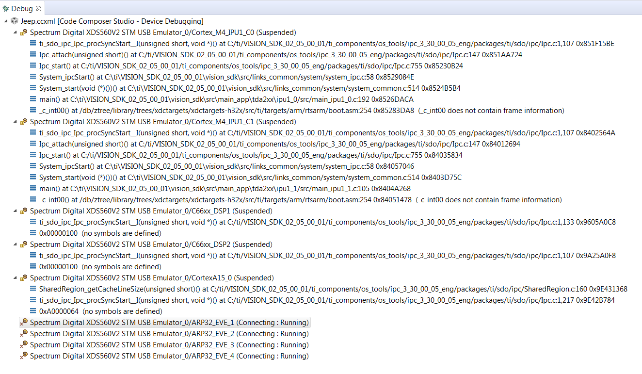

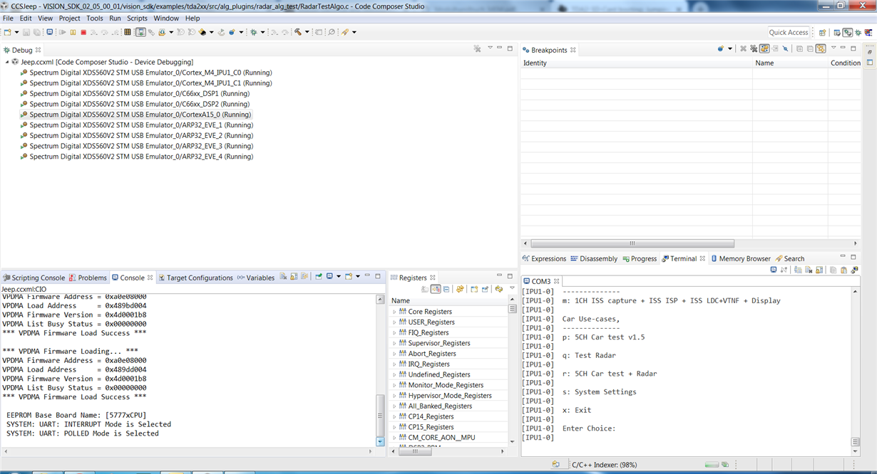

I included into Vision SDK a new Link and Usecase. With the Debugger the Code works fine.
I tried to boot from an SD card. The TDA2 only works until "Jumping to MPU CPU0 Application..." appears in the Terminal.
The whole Terminal output is shown below. The SD card works, I tried a functional Appimage and everything was fine. I am not sure in what could be wrong. Is there anything I have to add in the Imagegenerator when I include a new Usecase?
