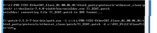

RTOS/AM3359: Building full feature EtherCAT Slave Application can not generate the patched EtherCAT Slave stack code source files
Part Number: AM3359
Tool/software: TI-RTOS
I do every step  as the description in PRU ICSS EtherCAT Slave User Guide.There is no hint and no response.Of course no  source files was  generated.I do not know what happend,Thanks and forgive me for my poor Eglish.
  • Hi no sure what it can be wrong.. I just tried and worked for me
    C:\TI\PRU-ICSS-EtherCAT_Slave_01.00.06.01\third_party\protocols\ethercat_slave\patch>unix2dos.exe TI_ECAT.patch
    unix2dos: converting file TI_ECAT.patch to DOS format...
    C:\TI\PRU-ICSS-EtherCAT_Slave_01.00.06.01\third_party\protocols\ethercat_slave\patch>patch.exe -i C:\TI\PRU-ICSS-EtherCAT_Slave_01.00.06.01\third_party\protocols\ethercat_slave\patch\TI_ECAT.patch -d
    C:\Users\alice\Desktop\TechSupport\Industrial\EtherCAT_slave_stack_5.1.2\SSC_V5i12\SlaveFiles\src
    Maybe your EtherCAT_slave_stack_5.1.2\SSC_V5i12\SlaveFiles\src cannot be written?
