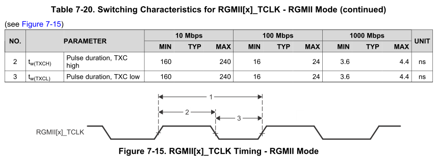

Part Number: AM3359
The cycle time for TXC was removed from Table 7-20 on the datasheet which is changed from SPRS717J to SPRS717K.
Is this a typo?
