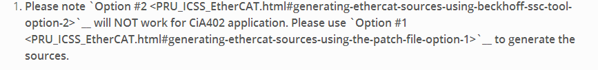

Hello!

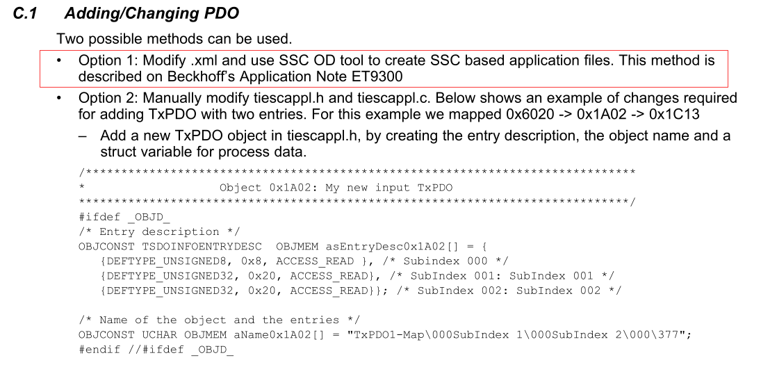

I have saw the file named PRU-ICSS EtherCAT Slave Troubleshooting Guide.   I got  some questions:
How many ways to change or add  PDO?
Why does the second method do not use xml file?
How does the second method config the esc's registers?
Where  can I find the details of the first method? Of course I have  browsed the Beckhoff's page and I  did not find details.
Last ,I want to use the first method to realize the CIA402 part .The first method need to use SSC,but, the file  PRU ICSS EtherCAT Slave User Guide said that Option #2 <PRU_ICSS_EtherCAT.html#generating-ethercat-sources-using-beckhoff-ssc-tool-option-2>`__ will NOT work for CiA402 application. I do not know if CIA402 can work with the first method.
Than you for your help and forgive me for my terrible Eglish!!!!!!!
