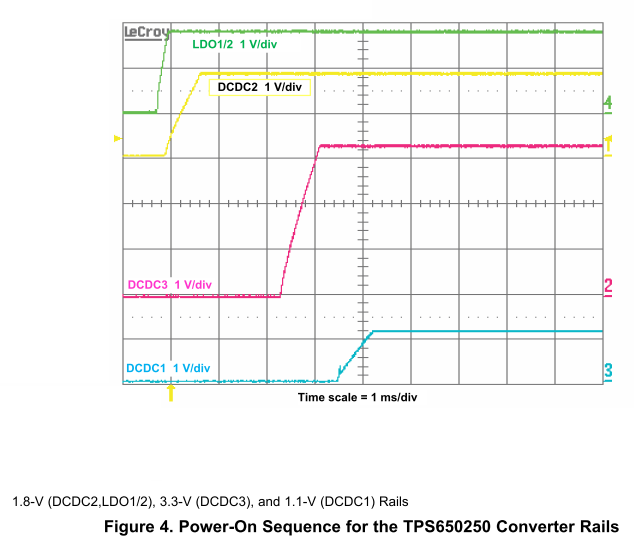

AM3359: Requirement added for Power-Supply Sequencing
Part Number: AM3359
Other Parts Discussed in Thread: TPS65218, TPS650250, TPS65216,
The requirement was added to footnotes of each from Figure 6-2 to Figure 6-6 on the datasheet which is changed from SPRS717J to SPRS717K.
"If all the 1.8-V supplies are not sourced from the same power supply, it is required to power up VDDS before other
 1.8-V supplies. Further, it is also recommended to source VDDS and VDDSHvx [x = 1-6] when configured as 1.8V
 from the same power supply.
What problems occur if VDDS is powered up later than other 1.8-V supplies?
