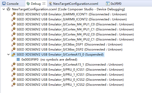

I want to run the No OS (Bare Metal) Example on the MINI5728
After I right click CortexA15_0 and select connect target., CCS prompts that Break at address "0x3f9f0" with no debug information available, or outside of program code.

How should I solve this problem?
Thank you!
  • Hi Wei,
    This is not an error or problem of any sort. The debugger is simply telling you that after you connected to the target, the program counter is halted at address 0x3f9f0, and that there is no source code associated at that address. If you have not loaded ant debug symbols yet, then this is actually the expected behavior.

  • In order to display as the following picture, what debugging symbols should I add?
    This image is from Processor SDK RTOS.
    When I debug the following code, the program can resume correctly to the location of the breakpoint, and the console will output Hello World! But if I continue to click resume, or resume directly without adding the breakpoint in the source code, the console will output CortexA15_0: Unhandled ADP_Stopped exception 0x80013B48.

  • How did you start a debug session? Did you use the "Debug" button to debug a project? If so, then symbols will be auto-loaded on program load.
    As for the unhandled exception, I don't know too much about that. It would be best to post a separate question in the Processors forum so the device experts can take a look.
