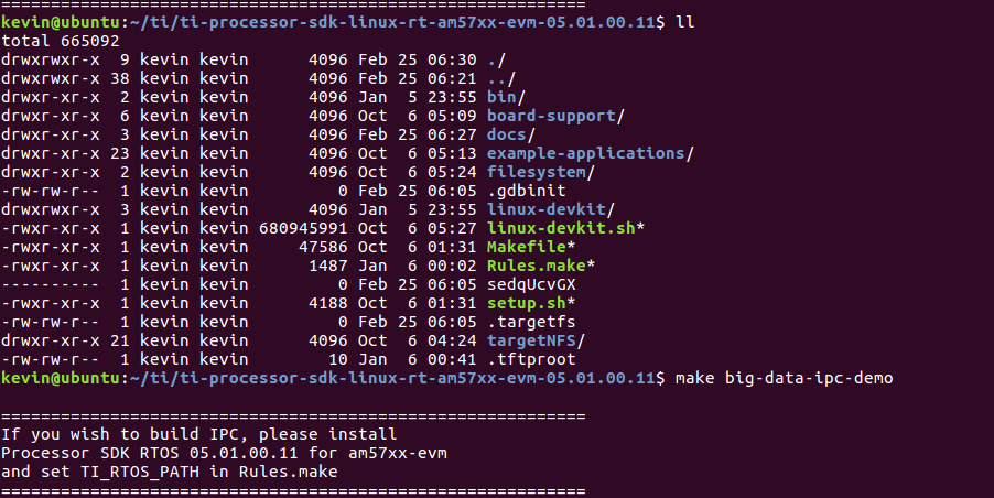

I want to build the IPC example demos but failed. just as the picture below:
I do not know how to install Processor SDK RTOS 05.01.00.11 for am57xx-evm, I think I have installed it already(since the directory is /~/ti/ti-processor-sdk-linux-rt-am57xx-evm-05.01.00.11$);
And I also do not know what is the TI_RTOS_PATH is. could you please tell me?
thanks.
  • Currently I can build it by setting correct TI_RTOS_PATH. After typing "make all", is can start to build.

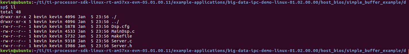

    Building project: am335x
    Output files can be found in the "gen" directory
    Finished building project: am335x
    make[2]: Leaving directory '/home/kevin/ti/ti-processor-sdk-linux-rt-am57xx-evm-05.01.00.11/example-applications/pru-icss-5.3.0/labs/lab_0/solution/am335x'
    make[2]: Entering directory '/home/kevin/ti/ti-processor-sdk-linux-rt-am57xx-evm-05.01.00.11/example-applications/pru-icss-5.3.0/labs/lab_0/solution/am437x'
    Building project: am437x
    Finished building project: am437x
    make[2]: Leaving directory '/home/kevin/ti/ti-processor-sdk-linux-rt-am57xx-evm-05.01.00.11/example-applications/pru-icss-5.3.0/labs/lab_0/solution/am437x'
    make[2]: Entering directory '/home/kevin/ti/ti-processor-sdk-linux-rt-am57xx-evm-05.01.00.11/example-applications/pru-icss-5.3.0/labs/lab_0/solution/am572x'
    Building project: am572x
    Finished building project: am572x
    make[2]: Leaving directory '/home/kevin/ti/ti-processor-sdk-linux-rt-am57xx-evm-05.01.00.11/example-applications/pru-icss-5.3.0/labs/lab_0/solution/am572x'
    make[2]: Entering directory '/home/kevin/ti/ti-processor-sdk-linux-rt-am57xx-evm-05.01.00.11/example-applications/pru-icss-5.3.0/labs/lab_0/solution/am65x'
    Building project: am65x
    Finished building project: am65x
    make[2]: Leaving directory '/home/kevin/ti/ti-processor-sdk-linux-rt-am57xx-evm-05.01.00.11/example-applications/pru-icss-5.3.0/labs/lab_0/solution/am65x'
    make[2]: Entering directory '/home/kevin/ti/ti-processor-sdk-linux-rt-am57xx-evm-05.01.00.11/example-applications/pru-icss-5.3.0/labs/lab_0/solution/k2g'
    Building project: k2g
    Finished building project: k2g
    make[2]: Leaving directory '/home/kevin/ti/ti-processor-sdk-linux-rt-am57xx-evm-05.01.00.11/example-applications/pru-icss-5.3.0/labs/lab_0/solution/k2g'
    make[2]: Entering directory '/home/kevin/ti/ti-processor-sdk-linux-rt-am57xx-evm-05.01.00.11/example-applications/pru-icss-5.3.0/labs/lab_1/solution/toggle_led'
    Building project: toggle_led
    Finished building project: toggle_led
    make[2]: Leaving directory '/home/kevin/ti/ti-processor-sdk-linux-rt-am57xx-evm-05.01.00.11/example-applications/pru-icss-5.3.0/labs/lab_1/solution/toggle_led'
    make[2]: Entering directory '/home/kevin/ti/ti-processor-sdk-linux-rt-am57xx-evm-05.01.00.11/example-applications/pru-icss-5.3.0/labs/lab_2/solution/button_led_0'
    Building project: button_led_0
    Finished building project: button_led_0
    make[2]: Leaving directory '/home/kevin/ti/ti-processor-sdk-linux-rt-am57xx-evm-05.01.00.11/example-applications/pru-icss-5.3.0/labs/lab_2/solution/button_led_0'
    make[2]: Entering directory '/home/kevin/ti/ti-processor-sdk-linux-rt-am57xx-evm-05.01.00.11/example-applications/pru-icss-5.3.0/labs/lab_2/solution/button_led_1'
    Building project: button_led_1
    Finished building project: button_led_1
    make[2]: Leaving directory '/home/kevin/ti/ti-processor-sdk-linux-rt-am57xx-evm-05.01.00.11/example-applications/pru-icss-5.3.0/labs/lab_2/solution/button_led_1'
    make[2]: Entering directory '/home/kevin/ti/ti-processor-sdk-linux-rt-am57xx-evm-05.01.00.11/example-applications/pru-icss-5.3.0/labs/lab_3/solution/PRU_HDQ_TempSensor0'
    Building project: PRU_HDQ_TempSensor0
    Finished building project: PRU_HDQ_TempSensor0
    make[2]: Leaving directory '/home/kevin/ti/ti-processor-sdk-linux-rt-am57xx-evm-05.01.00.11/example-applications/pru-icss-5.3.0/labs/lab_3/solution/PRU_HDQ_TempSensor0'
    make[2]: Entering directory '/home/kevin/ti/ti-processor-sdk-linux-rt-am57xx-evm-05.01.00.11/example-applications/pru-icss-5.3.0/labs/lab_3/solution/PRU_HDQ_TempSensor1'
    Building project: PRU_HDQ_TempSensor1
    Finished building project: PRU_HDQ_TempSensor1
    make[2]: Leaving directory '/home/kevin/ti/ti-processor-sdk-linux-rt-am57xx-evm-05.01.00.11/example-applications/pru-icss-5.3.0/labs/lab_3/solution/PRU_HDQ_TempSensor1'
    make[2]: Entering directory '/home/kevin/ti/ti-processor-sdk-linux-rt-am57xx-evm-05.01.00.11/example-applications/pru-icss-5.3.0/labs/lab_4/solution/button_led_0'
    make[2]: Leaving directory '/home/kevin/ti/ti-processor-sdk-linux-rt-am57xx-evm-05.01.00.11/example-applications/pru-icss-5.3.0/labs/lab_4/solution/button_led_0'
    make[2]: Entering directory '/home/kevin/ti/ti-processor-sdk-linux-rt-am57xx-evm-05.01.00.11/example-applications/pru-icss-5.3.0/labs/lab_4/solution/button_led_1'
    make[2]: Leaving directory '/home/kevin/ti/ti-processor-sdk-linux-rt-am57xx-evm-05.01.00.11/example-applications/pru-icss-5.3.0/labs/lab_4/solution/button_led_1'
    make[2]: Entering directory '/home/kevin/ti/ti-processor-sdk-linux-rt-am57xx-evm-05.01.00.11/example-applications/pru-icss-5.3.0/labs/lab_5/solution/am335x/PRU_RPMsg_Echo_Interrupt1'
    Building project: PRU_RPMsg_Echo_Interrupt1
    Finished building project: PRU_RPMsg_Echo_Interrupt1
    make[2]: Leaving directory '/home/kevin/ti/ti-processor-sdk-linux-rt-am57xx-evm-05.01.00.11/example-applications/pru-icss-5.3.0/labs/lab_5/solution/am335x/PRU_RPMsg_Echo_Interrupt1'
    make[2]: Entering directory '/home/kevin/ti/ti-processor-sdk-linux-rt-am57xx-evm-05.01.00.11/example-applications/pru-icss-5.3.0/labs/lab_5/solution/am437x/PRU_RPMsg_Echo_Interrupt1_1'
    Building project: PRU_RPMsg_Echo_Interrupt1_1
    Finished building project: PRU_RPMsg_Echo_Interrupt1_1
    make[2]: Leaving directory '/home/kevin/ti/ti-processor-sdk-linux-rt-am57xx-evm-05.01.00.11/example-applications/pru-icss-5.3.0/labs/lab_5/solution/am437x/PRU_RPMsg_Echo_Interrupt1_1'
    make[2]: Entering directory '/home/kevin/ti/ti-processor-sdk-linux-rt-am57xx-evm-05.01.00.11/example-applications/pru-icss-5.3.0/labs/lab_5/solution/am572x/PRU_RPMsg_Echo_Interrupt1'
    make[2]: Leaving directory '/home/kevin/ti/ti-processor-sdk-linux-rt-am57xx-evm-05.01.00.11/example-applications/pru-icss-5.3.0/labs/lab_5/solution/am572x/PRU_RPMsg_Echo_Interrupt1'
    make[2]: Entering directory '/home/kevin/ti/ti-processor-sdk-linux-rt-am57xx-evm-05.01.00.11/example-applications/pru-icss-5.3.0/labs/lab_5/solution/am65x/PRU_RPMsg_Echo_Interrupt1'
    make[2]: Leaving directory '/home/kevin/ti/ti-processor-sdk-linux-rt-am57xx-evm-05.01.00.11/example-applications/pru-icss-5.3.0/labs/lab_5/solution/am65x/PRU_RPMsg_Echo_Interrupt1'
    make[2]: Entering directory '/home/kevin/ti/ti-processor-sdk-linux-rt-am57xx-evm-05.01.00.11/example-applications/pru-icss-5.3.0/labs/lab_5/solution/k2g/PRU_RPMsg_Echo_Interrupt1'
    make[2]: Leaving directory '/home/kevin/ti/ti-processor-sdk-linux-rt-am57xx-evm-05.01.00.11/example-applications/pru-icss-5.3.0/labs/lab_5/solution/k2g/PRU_RPMsg_Echo_Interrupt1'
    make[2]: Entering directory '/home/kevin/ti/ti-processor-sdk-linux-rt-am57xx-evm-05.01.00.11/example-applications/pru-icss-5.3.0/labs/lab_5/solution/am335x/PRU_Halt'
    Building project: PRU_Halt
    Finished building project: PRU_Halt
    make[2]: Leaving directory '/home/kevin/ti/ti-processor-sdk-linux-rt-am57xx-evm-05.01.00.11/example-applications/pru-icss-5.3.0/labs/lab_5/solution/am335x/PRU_Halt'
    make[2]: Entering directory '/home/kevin/ti/ti-processor-sdk-linux-rt-am57xx-evm-05.01.00.11/example-applications/pru-icss-5.3.0/labs/lab_5/solution/am437x/PRU_Halt'
    make[2]: Leaving directory '/home/kevin/ti/ti-processor-sdk-linux-rt-am57xx-evm-05.01.00.11/example-applications/pru-icss-5.3.0/labs/lab_5/solution/am437x/PRU_Halt'
    make[2]: Entering directory '/home/kevin/ti/ti-processor-sdk-linux-rt-am57xx-evm-05.01.00.11/example-applications/pru-icss-5.3.0/labs/lab_5/solution/am572x/PRU_Halt'
    make[2]: Leaving directory '/home/kevin/ti/ti-processor-sdk-linux-rt-am57xx-evm-05.01.00.11/example-applications/pru-icss-5.3.0/labs/lab_5/solution/am572x/PRU_Halt'
    make[2]: Entering directory '/home/kevin/ti/ti-processor-sdk-linux-rt-am57xx-evm-05.01.00.11/example-applications/pru-icss-5.3.0/labs/lab_5/solution/am65x/PRU_Halt'
    make[2]: Leaving directory '/home/kevin/ti/ti-processor-sdk-linux-rt-am57xx-evm-05.01.00.11/example-applications/pru-icss-5.3.0/labs/lab_5/solution/am65x/PRU_Halt'
    make[2]: Entering directory '/home/kevin/ti/ti-processor-sdk-linux-rt-am57xx-evm-05.01.00.11/example-applications/pru-icss-5.3.0/labs/lab_5/solution/k2g/PRU_Halt'
    make[2]: Leaving directory '/home/kevin/ti/ti-processor-sdk-linux-rt-am57xx-evm-05.01.00.11/example-applications/pru-icss-5.3.0/labs/lab_5/solution/k2g/PRU_Halt'
    make[2]: Entering directory '/home/kevin/ti/ti-processor-sdk-linux-rt-am57xx-evm-05.01.00.11/example-applications/pru-icss-5.3.0/labs/lab_6/solution/PRU_RPMsg_LED0'
    Building project: PRU_RPMsg_LED0
    Finished building project: PRU_RPMsg_LED0
    make[2]: Leaving directory '/home/kevin/ti/ti-processor-sdk-linux-rt-am57xx-evm-05.01.00.11/example-applications/pru-icss-5.3.0/labs/lab_6/solution/PRU_RPMsg_LED0'
    make[1]: Leaving directory '/home/kevin/ti/ti-processor-sdk-linux-rt-am57xx-evm-05.01.00.11/example-applications/pru-icss-5.3.0/labs'
    I cannot find the output files in "gen" directory. Why?
  •  Also after typing "make ipc_demo" I could not find the generated outputs in the /dsp directory, just as the picture.
    I donnot know how to generate the outputs just like the examples :
