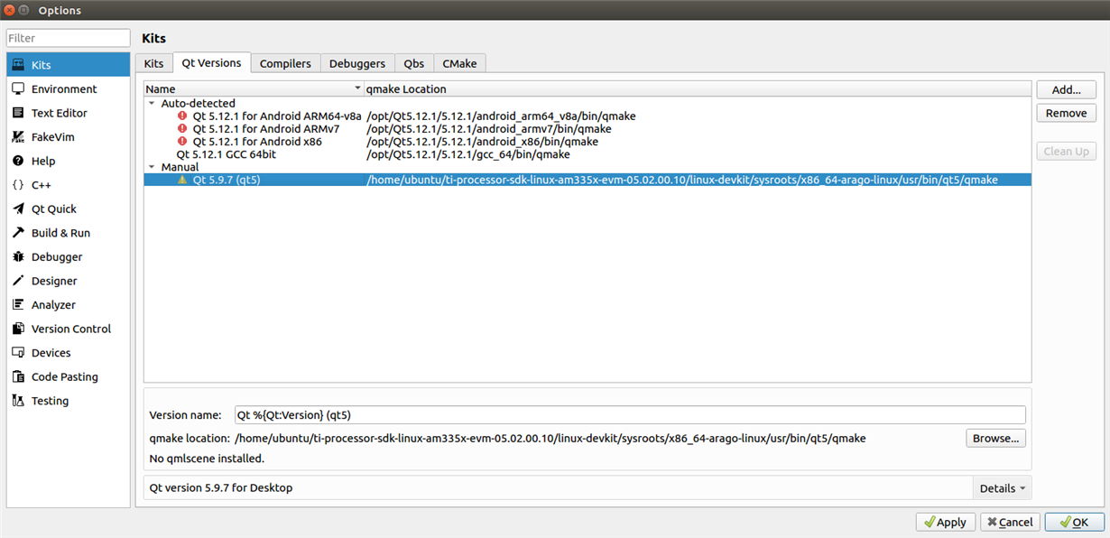

I am working on AM335x Linux Qt, i installed Qt Creator 4.8.1 Based on Qt 5.12.1.
I followed this steps http://processors.wiki.ti.com/index.php/Sitara_Linux_Training:_Hands_on_with_QT  to configure Qt for AM335x, but i getting this following error
"no qmlscene installed" in Qt versions.
even though I installed this but it couldn't help:
      $ sudo apt install qtdeclarative5-dev
      $ sudo apt-get install qmlscene
Why is there a warning? How can I resolve it? also i upload screenshots ,
  • Hello Harshad,
    You are facing this issue because you have added the Qt Version -> Qt 5.9.7 (qt5) without having the environment-setup sourced in the same terminal window from where the qtcreator was invoked and the Qt version was registered for Desktop variant as shown in the screenshot.
    To exit from this situation you just need to Remove the current Qt Version -> Qt 5.9.7 (qt5) and re-add it back, but this time make sure that you have the environment-setup sourced in the same terminal window before invoking the qtcreator and the Qt version should this time be registered as for Embedded Linux.
