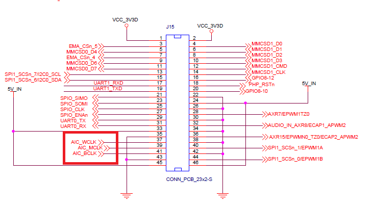

I have configured the onboard codec AIC3106 in master mode and configured its sampling rate to be 48kHz when I record the data and plot it in Matlab, the sampling rate happens to 62640Hz. After searching the forum, I came through this post and did the changes but still the sampling rate is 47990Hz instead of 48kHz. (I got this result by taking FFT of 1-second samples )
What is the problem here? How do I get 48kHz and also is it possible to have a 96kHz sampling rate while using both the channels, How? can you provide code for that?
