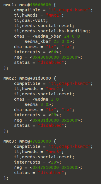

  • Hi Andrew,
    The assignment of mmc modules in Linux is based on the entries in am33xx.dtsi (see the below image). In the context of the device tree, mmc1 is always mmc1 because it is assigned to the specific memory address where that instance of the module resides. The confusion comes from the hardware numbering which starts at 1 but in Linux the "/dev/mmcblk" value starts at 0. So only in Linux does the SD Card on MMC1 change to be "mmcblk0" and eMMC on MMC2 => mmcblk1.
    Does this information help you with setting up the gpio-led? You can always use other board dts files as reference.
  • According to the TRM the IP blocks are zero based and the AM335x physically has mmc[0-2]. The device tree (am33xx.dtsi) names the modules using one based indexing and provides mmc[1-3]. As you mentioned, Linux also uses zero based numbering (So why are the mmc entries in the device tree one based?). So yes there is a difference but I don't think this is my problem.
    on the board with wifi:
    physical mmc0 registers as mmcblk1 (matches expected mmc1 device tree name)
    physical mmc1 registers as mmcblk2 (matches expected mmc2 device tree name)
    physical mmc2 (no mmcblk device as this is wifi, but dmesg shows a message for mmc0)
    on the board without wifi
    physical mmc0 registers as mmcblk0 (does not match expected mmc1 device tree name)
    physical mmc1 registers as mmcblk1 (does not match expected mmc2 device tree name)
    So a core device tree shared between both boards defining an led with a mmc1 trigger behaves differently. This is my problem.

  • As an experiment I modified the device tree to run all possible MMC combinations. Based on the results it looks like the MMC probe consistently starts at the module with the lowest physical address and then increments (for AM335x memory map mmc2 < mmc0 < mmc1). To keep things short I didn't include all the results, but the log messages below show the general trend.
    device tree: SD + EMMC + WIFI enabled
    # dmesg | grep mmc[012]
    [    1.438306] mmc0: new high speed SDIO card at address 0001
    [    1.719685] mmc1: host does not support reading read-only switch, assuming write-enable
    [    1.727845] mmc1: new high speed SDHC card at address aaaa
    [    1.734150] mmcblk1: mmc1:aaaa SL16G 14.8 GiB
    [    1.758374] mmc2: new high speed MMC card at address 0001
    [    1.764454] mmcblk2: mmc2:0001 W52532 28.5 GiB
    [    1.769241] mmcblk2boot0: mmc2:0001 W52532 partition 1 4.00 MiB
    [    1.775472] mmcblk2boot1: mmc2:0001 W52532 partition 2 4.00 MiB
    device tree: SD + EMMC enabled
    [    3.650171] mmc0: host does not support reading read-only switch, assuming write-enable
    [    3.664153] mmc0: new high speed SDHC card at address aaaa
    [    3.670343] mmcblk0: mmc0:aaaa SL16G 14.8 GiB
    [    3.680171] mmc1: new high speed MMC card at address 0001
    [    3.690132] mmcblk1: mmc1:0001 W52532 28.5 GiB
    [    3.694911] mmcblk1boot0: mmc1:0001 W52532 partition 1 4.00 MiB
    [    3.701155] mmcblk1boot1: mmc1:0001 W52532 partition 2 4.00 MiB
    device tree: EMMC enabled
    [    3.618187] mmc0: new high speed MMC card at address 0001
    [    3.624309] mmcblk0: mmc0:0001 W52532 28.5 GiB
    [    3.629151] mmcblk0boot0: mmc0:0001 W52532 partition 1 4.00 MiB
    [    3.635308] mmcblk0boot1: mmc0:0001 W52532 partition 2 4.00 MiB
    I think the rules determining the name that will be assigned to a device are predictable. So I can just redefine my LED triggers in the device tree file that supplies the WIFI bindings. It's just a shame the assigned name has nothing to do with the physical interface. At least serial ports don't behave this way...
