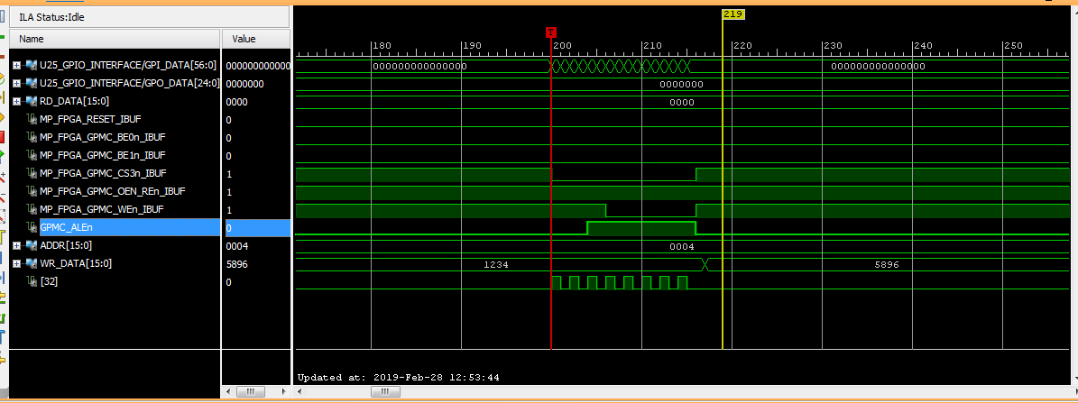

Dear Sir,

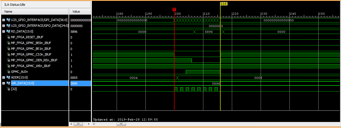

We are trying to enable the GPMC synchronous single  Write / Read operation with external FPGA using NOR protocol.  When we are performing write operation clock is GPMC_CLK is generating and data was written in FPGA but we cant read back the written data. But in asynchronous mode write and read operation is working fine. Please find the attached screen shorts of the wave forms captured in Vivado (FPGA chipscope) for the write ("5896" data is writing in address "4") & Read (data is reading from "5" th address) operation.

Write:
Read:
  • You should change: 0x8c (PIN_OUTPUT | MUX_MODE0) /* (V12) gpmc_clk.gpmc_clk */
    To: 0x8c (PIN_INPUT | MUX_MODE0) /* (V12) gpmc_clk.gpmc_clk */
  • Thanks for your reply.
    After changing the Clock Pin configuration as input. Data is reading the fine.
