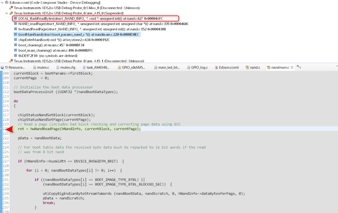

Using the debugger I can see the PC seems to be around 0x4AFC most the time, sometimes it is just stuck at 0x9B8 which I understand to be an error state.

    HEre is a quick screenshot from the setup and I am also sharing the NANDmain.c file for your reference. The A15 core when it is at 0x4AfC is at function hwNANDReadPage.

  • Hi Rahul,

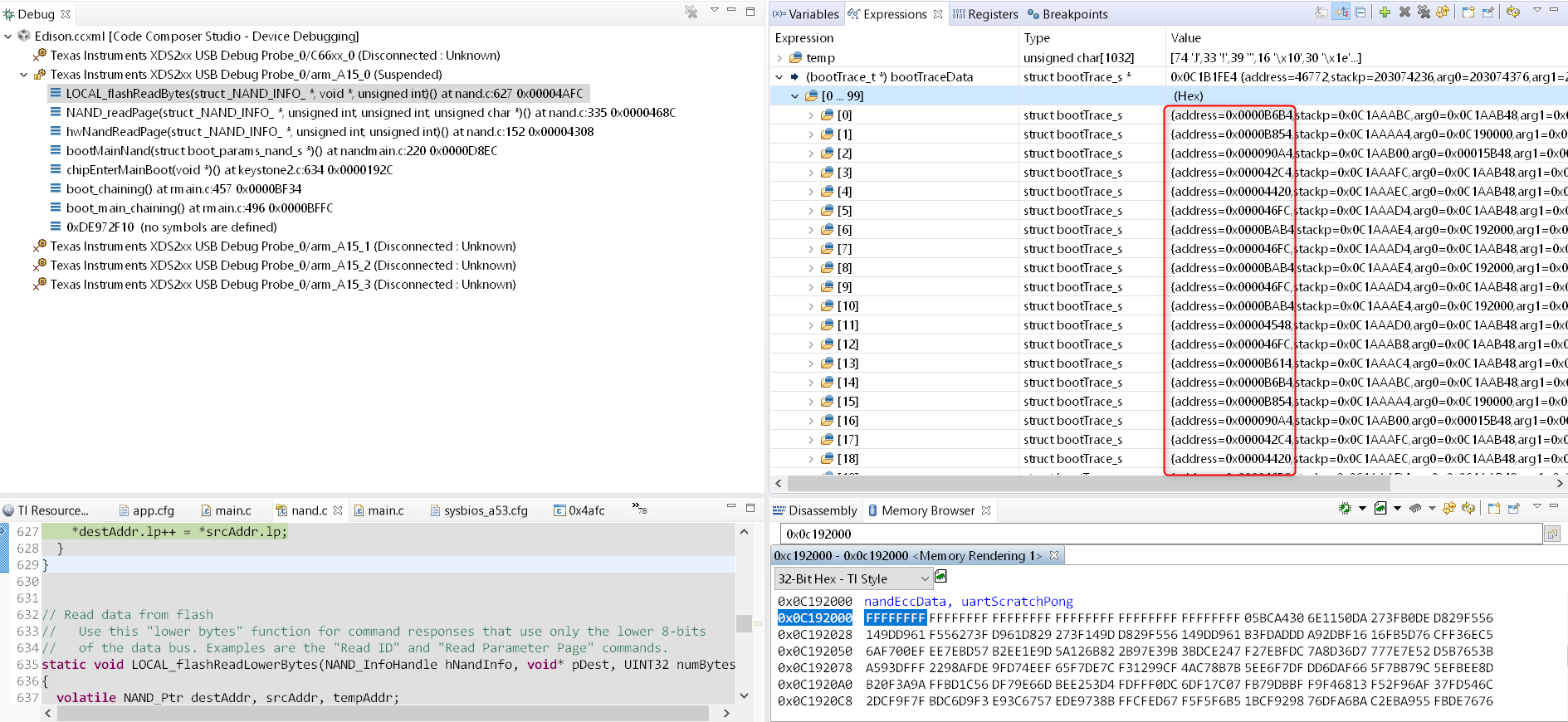

    Thanks for your response it is very helpful. I can see that my processor appears to be cycling that do loop at least. I put a breakpoint on address 0xD8EC which it does hit repeatedly so it does not hang. I can confirm that the flash is fully powered on before the SOC attempts to read.
    What would be most interesting is the return value of the hwReadNandPage function, or at least the program flow through this nandmain.c file. Do you have the disassembly alongside the source? then at least I can step through the addresses and put more breakpoints in to determine return values and order of operations.
    Otherwise thank you and I await you analysis of the trace information.

  • I looked at the Trace Data and Bootlog that you provided  and there are 10 log entries from the boot ROM and 9 of them are  from the  hwNANDReadPage function in NAND so definitely the NAND is being read.
    Refer to screenshot provided below for Boot Log:
    Boot Trace
    From the boot Trace information, there are 256 entries and many of them indicate page read and ECC compute, so I suspect there could be an issue with NAND read associated with ECC data in the spare area.
    I am sharing relevant symbol locations:
    • 0x00004260 _hwNandGetGeometry
    • 0x000042b0 _hwNandReadPage
    • 0x00004330 _NAND_open
    • 0x00004410 _NAND_badBlockCheck
    • 0x00004500 _NAND_reset
    • 0x00004530 _NAND_readPage
    • 0x000046e4 _NAND_readSpareBytesOfPage
    • 0x00004864 _nandImportParams
    • 0x0000b608 _DEVICE_NAND_ECC_enable
    • 0x0000b654 _DEVICE_NAND_ECC_disable
    • 0x0000b69c _DEVICE_NAND_ECC_read
    • 0x0000b840 _DEVICE_NAND_ECC_correct
    • 0x000baa8 _DEVICE_NAND_BB_checkSpareBytes
    • 0x0000bae8 _DEVICE_NAND_setEmifBusWidth
    Here is a screenshot from the BootTrace information and also a view at the location where the ROM put the ECC data:
    I will try to capture the same from a working NAND boot setup so you have reference of what to expect.
    Rahul
    PS: Click on the images to zoom or right click and download for a zoomed in view.
