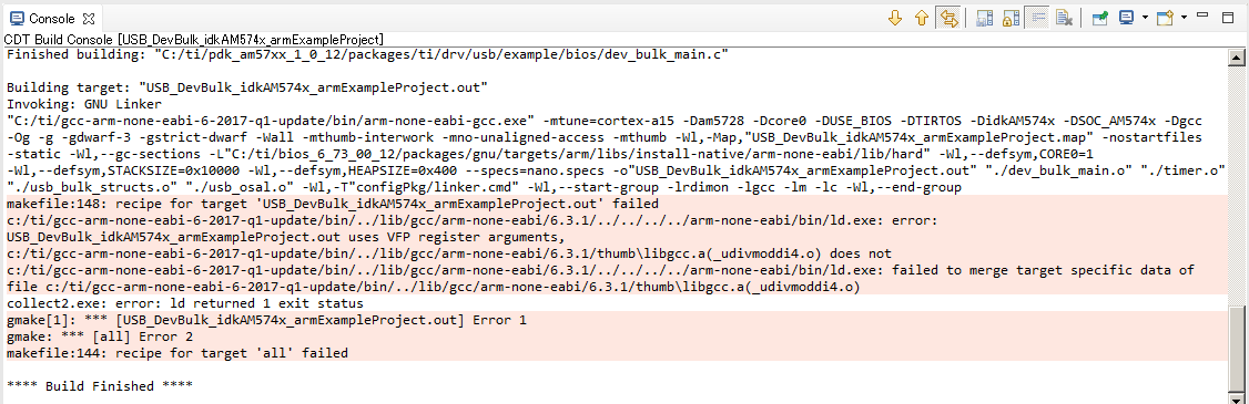

    When I changed the options , the following error occurred.
    Could you tell me the solution?

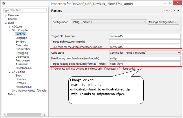

    ■Changed options
    Code stage : -marm to -mthumb
    -mfloat-abi = hard to softfp
    -mfpu = (blank) to neon-vfpv4
    ■Error message

  • You seem to be using incompatible compiler options as the thumb mode of libgcc was not built with the VFP option. there is a work around provided by our compiler team here:

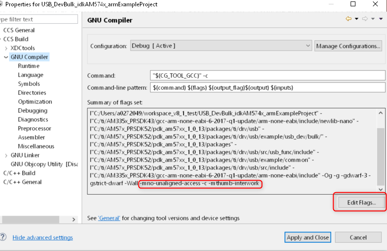

  • Rei,
    you can add the -mfpu setting  and the unalgined access setting to the flags in the CCS project using Edit flags option in the GNU compiler settings options as shown below:
    However, we don`t support thumb mode compilation for A15 cores with Processor SDK RTOS. Thumb mode uses 16 bit instruction set and you will need the entire software stack built in this mode.  Also, compiling hardfp libraries with application that uses softfp is not compatible. You need to get your whole system configured one way or the other.
