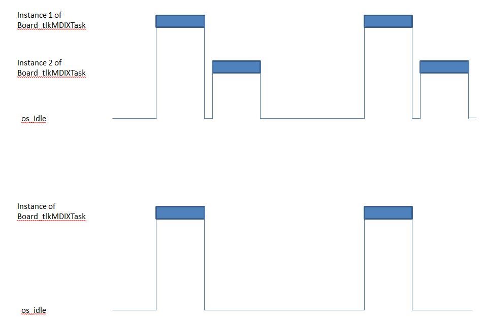

  • Hi Hisao,
    I'm not familiar with that API and could not find it in the PDK, but if it calls TI-RTOS's Task_create, then multiple unique tasks are created. Each will have the same entry function and priority, but each will have it's own stack.

  • Hisao,
    If you create one instance of the above task (via one call to TaskOSAL_create), it will run when it is the highest priority thread ready to run. It calls the first TaskOSAL_sleep and will then sleep for 2500ms. Other threads will run during this sleep (e.g. Idle). Once in the while loop, it will do the Swap function and then again sleep for 2500ms.

  • Hi Todd,
    Sorry to confusing you.
    The software calls task_create() two times as below.
    TaskOSAL_create(3, taskname, 0x1000, baseAddress, Board_tlkMDIXTask);
    Is the task Board_tlkMDIXTask() executed twice or once? Which upper or bottom is correct?
    Uchikoshi
  • The upper picture.
