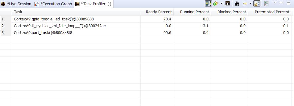

I am evaluating rtos_template_app_am437x_a9 in Processor SDK RTOS.
It runs properly on TMDSIDK437x by editting gpio configuration.
When I saw RTOS Analyzer result, I can't see gpio_toggle_led_task running in RTOS Analyzer in spite of EVM's led blinking.
And Running Percent of gpio_led_task is zero as following.
Current .cfg file is as below.
3582.app.cfg
Are there any additional setting to solve this issue?

    I saw your app.cfg doesn't have UIA modules inside, please check software-dl.ti.com/.../index_dsp_sw.html
    Regards, Eric

    Sorry, I attached wrong file.
    Please confirm following file.

    LoggingSetup.sysbiosSwiLogging = true;
    LoggingSetup.sysbiosHwiLogging = true;
    LoggingSetup.sysbiosSemaphoreLogging = true;
    LoggingSetup.enableTaskProfiler = true;
    LoggingSetup.enableContextAwareFunctionProfiler = true;
    LoggingSetup.sysbiosLoggerSize = 524288;

    We have one tested for AM335x, this should work for AM437x as well. Please see the attached one up to line 150 (after that is AM335x driver/MMU/cache setup, you can use what you have for AM437x).7848.am335x_app_bbbam335x.cfg
    Regards, Eric
