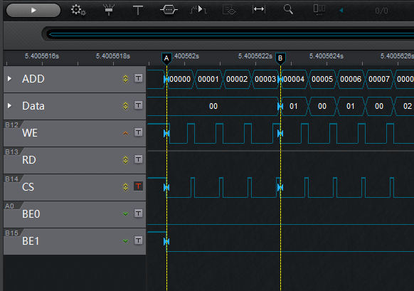

I'm studying to access a asynchronous SRAM(16bits,1MByte) on AM437x GPMC.Two examples are used :enet_app_tcpecho, and Nimu_BasicExample_skAM437x_armExampleproject. and its use the same GPMC init function as follow:

and I use a type uint64_t variable to perform continuous read and write operations.
but I find that there is no time delay between two read or write operations in the example enet_app_tcpecho, while there is about 300ns time delay between two read or write operations in the example Nimu_BasicExample_skAM437x_armExampleproject. ,
I wonder if it's because these two examples call different MMU initializing function.(MMUConfigAndEnable() and CACHEEnable(CACHE_IDCACHE, CACHE_INNER_OUTER) in the enet_app_tcpecho,SDKMMUInit(applMmuEntries) in the Nimu_BasicExample_skAM437x_armExampleproject)
pdk_am437x_1_0_10, sysbios_ind_sdk_2.1.0.1
CCS7
What's the difference between MMU and cache initialization in these two examples? Why do SRAM access timing differ?

  • Hi Eric,
    I looked though the examples, I think that it is for the FLASH chip, not for the SRAM, the read and write operation will be big different. so I refered to the example "nand_app_read_write" in the sysbios_ind_sdk_2.1.0.1, and transplanted its hardware driver. now the code can work orderly. but when I transplanted this code to TI-RTOS( example Nimu_BasicExample_skAM437x_armExampleproject), I found the delay.
    do you the code for SRAM operation in SDK RTOS? or any advice?
    can you tell me the different between the function SDKMMUInit() and the function MMUConfigAndEnable() and CACHEEnable()?

  • Hi Eric,
    I compared the gpmc_arm_evmam437x.cfg with the .cfg and MMU init code(the function SDKMMUInit()) of NIMU_BasicExample_skAM437x_armExampleproject, I thank that they perform the same functions.
    and I want you to notice the different initialization parameters of the MMU in the example tcpecho of sysbios_ind_sdk_2.1.0.1,it call the mmu init function in the example_utils_mmu.c with the parameter as follow:
    mmuMemRegionConfig_t regionSRAM =
                    0x1000000,
                    1,
                    1*MEM_SIZE_MB,
                    MMU_MEM_ATTR_DEVICE_NON_SHAREABLE,
                    MMU_CACHE_POLICY_WT_NOWA,
                    MMU_ACCESS_CTRL_PRV_RW_USR_RW,
                    FALSE
    these parameter may not be used in the Processor SDK RTOS init codes.
    I understand what you mean. I will use the API to initialize the GPMC, and write my own program to read and write SRAM.
    but I  researched the GPMC setting parameters GPMC_v1_HwAttrs_s in the GPMC_v1.h, many of these parameters are not well understood.
    As I mentioned earlier in the init code, the SRAM CS is connected to the gpmc_csn1, physical base address is 0x1000000, address space is 16MBytes,
    How to set these parameters of GPMC_v1_HwAttrs_s?

  • Hi Eric,
    In the cfg, do I need to setup MMU for the SRAM baseaddress( 0x100000)?
    My SRAM baseaddress is 0x1000000. in the .cfg file, do I need to add the codes as follow:
    var peripheralBaseAddr = 0x1000000;
    /* Configure the corresponding MMU page descriptor accordingly */
    Mmu.setFirstLevelDescMeta(peripheralBaseAddr,   peripheralBaseAddr,  peripheralAttrs);
    I do it, and the results is same as the one of NIMU_BasicExample_skAM437x_armExampleproject, there is a about 260ns delay after each access.

    You wanted this setup using SYSBIOS
    0x1000000,
    1,
    1*MEM_SIZE_MB,
    FALSE
    I found this E2E: e2e.ti.com/.../1395492
    In order to mark a memory page as write-through cacheable, you will need to update that page's corresponding MMU entry. To change the cacheability of a page to outer and inner write-through no write-allocated, set the TEX[2:0] attribute for the page to 0, cacheable to true and bufferable to false. Here's some untested code showing how to do this using SYS/BIOS APIs:
    Mmu_FirstLevelDescAttrs attrs;
    Mmu_initDescAttrs(&attrs);
    attrs.type = Mmu_FirstLevelDescType_SECTION;
    attrs.tex = 0;
    attrs.cacheable = true;
    attrs.bufferable = false;
    attrs.shareable = false;
    You can refer to ARM architecture document static.docs.arm.com/.../DDI0406C_C_arm_architecture_reference_manual.pdf. B3.8.2 Short-descriptor format memory region attributes, without TEX remap for the combination of TEX, B-bit and C-bit to achieve Outer and Inner Write-Through, no Write-Allocate.
    Regards, Eric
  • Hi Eric,
    I change the settings as what you tell me. now it is ok.
    Thank you very much!

  • Yes,I see.
    Thank you very much!!
    I  had tried the
    MU_MEM_ATTR_DEVICE_SHAREABLE,
    MMU_CACHE_POLICY_WB_WA,     /* Inner - Invalid here */
    MMU_CACHE_POLICY_WB_WA,     /* Outer - Invalid here */
    with
    attrs.tex = b'001;
    attrs.bufferable = true;
    attrs.shareable = true;
    its codes as follow:
    SYS_MMU_ENTRY applMmuEntries[] = {
        {(void*)0x40300000,0},  //OCMCRAM  - Cacheable
        {(void*)0x44D00000, SYS_MMU_BUFFERABLE},  //PRCM - Non bufferable| Non Cacheable
        {(void*)0x44E00000, SYS_MMU_BUFFERABLE},  //Clock Module, PRM, GPIO0, UART0, I2C0, - Non bufferable| Non Cacheable
        {(void*)0x47900000,0},  //QSPI MMR Maddr0space
        {(void*)0x48000000, SYS_MMU_BUFFERABLE},  //UART1,UART2,I2C1,McSPI0,McASP0 CFG,McASP1 CFG,DMTIMER,GPIO1 -Non bufferable| Non Cacheable
        {(void*)0x48100000,0},  //I2C2,McSPI1,UART3,UART4,UART5, GPIO2,GPIO3,MMC1 - Non bufferable| Non Cacheable
        {(void*)0x48200000, SYS_MMU_BUFFERABLE},  //
        {(void*)0x48300000, SYS_MMU_BUFFERABLE},  //PWM - Non bufferable| Non Cacheable
        {(void*)0x49000000, SYS_MMU_BUFFERABLE},   //EDMA3CC - Non bufferable| Non Cacheable
        {(void*)0x4A000000, SYS_MMU_BUFFERABLE},  //L4 FAST CFG- Non bufferable| Non Cacheable
        {(void*)0x4A100000, SYS_MMU_BUFFERABLE},  //CPSW - Non bufferable| Non Cacheable
        {(void*)0x50000000, 0},  //GPMC Configure -Bufferable| Non Cacheable | Shareable
        {(void*)0x54400000, 0},  //PRU-ICSS0/1 -Bufferable| Non Cacheable | Shareable
        {(void*)0xFFFFFFFF,0xFFFFFFFF}
        Mmu_disable();
        attrs.type = Mmu_FirstLevelDesc_SECTION;
        attrs.domain = 0;
        attrs.imp = 1;
        attrs.accPerm = 3;
        attrs.tex = 1;
        attrs.bufferable = 1;
        attrs.cacheable  = 1;
        attrs.shareable  = 1;
        attrs.noexecute  = 1;
        for(itr = 0 ; mmuEntries[itr].address != (void*)0xFFFFFFFF ; itr++)
            Mmu_setFirstLevelDesc((Ptr)(mmuEntries[itr].address), (Ptr)(mmuEntries[itr].address) , &attrs);  // PWM
    for the device. and I found that it did not work orderly. if It changed as follow:
        attrs.tex = 0;
        attrs.bufferable = 0;
        attrs.cacheable  = 0;
        attrs.shareable  = 0;
    it is ok.
    any advice?
