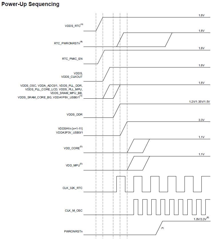

Please let me know about the power up sequence of DDR_VREF.
On my customer's board, DDR_VREF rise after 4msec of VDDS_DDR.
Is this sequence correct?
There is no DDR_VREF in the following sequence diagram of DS.
My customer should start DDR_VREF at this timing in this sequence?
