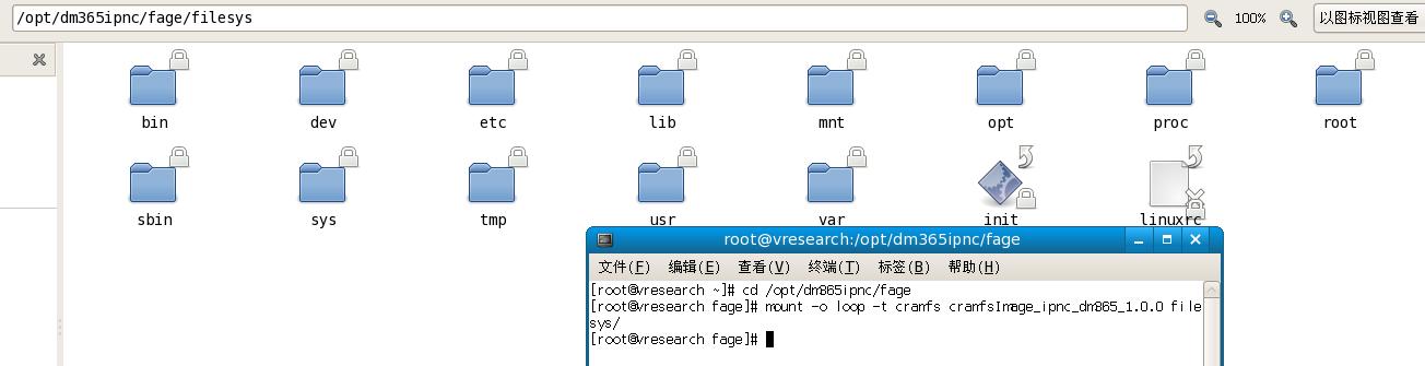

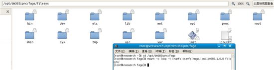

  • Hi All,
    I also cound not boot from nfs on DM365 ipnc-MT5.
    According to the Posted by on 25 Sep 2009 12:42 AM , I try to modify lsp_ipnc_dm36x_1.0.0.tgz, configuring  CONFIG_TI_DAVINCI_EMAC to 'y', I also modify File Systems according to seeddsp's dm365 EVM. Then booting as follow,

    ///////////////////////////////////////NFS File system installing/////////////////////////////////
    (1)I do it according DM365PrivatePackage\Docs\Users_Guide_IPNC_DM365.pdf(section 2.4), show as picture 1,  so the nfs rootpath is /opt/dm365ipnc/fage/filesys.
     (2) Another way i do it is like that, so the another nfs rootpath is /opt/dm365ipnc/nfs_target.

    # cd /mnt
    # mount -t nfs 192.168.1.240:/opt/dm365ipnc/fage/filesys /mnt/mmc
    mount: 192.168.1.240:/opt/dm365ipnc/fage/filesys failed, reason given by server: Permission denied
    # mount -t nfs 192.168.1.240:/opt/dm365ipnc/nfs_target /mnt/mmc
    # ls /mnt/mmc/
    bin    dev    home   media  opt    root   srv    tmp    var
    boot   etc    lib    mnt    proc   sbin   sys    usr

    Hi all,
     I use DM365 IPNC-MT5, meeting issues when boot from nfs.
     By the way, I really don't know SW version, maybe is ver1.0.
    (1) I do it according DM365PrivatePackage\Docs\Users_Guide_IPNC_DM365.pdf(section 2.4), so the nfs rootpath is /opt/dm365ipnc/rootfs/filesys.
    #cd /opt/dm365ipnc/rootfs
    #mkdir filesys
    #mount -o loop -t cramfs cramfsimage_ipnc_dm365_1.0.0 filesys
    (2) Another way i do it is copying the mount dir as follow, so the another nfs rootpath is /opt/dm365ipnc/rootfs/copyfilesys.
    # cd /opt/dm365ipnc/rootfs
    # mkdir copyfilesys
    # cd copyfilesys
    # cp cp -a /opt/dm365ipnc/rootfs/filesys/* .

    ////////////////////////////////////// NFS boot log/////////////////////////////////////////
    Booting from cramfs is ok, but if I boot from nfs, using rootpath /opt/dm365ipnc/rootfs/copyfilesys, the boot log is here,

    ////////////////////////////////////// Question/////////////////////////////////////////
     I could not boot from nfs using rootpath /opt/dm365ipnc/rootfs/filesys(I even could not mount it on linux host), I copy filesystem from mount, then meet a lot of errors(see NFS boot log), as I see it, booting from nfs using /opt/dm365ipnc/rootfs/copyfilesys should autostart applications normally, How do deal with it? Please guide me.
    swinter
  • Hi swinter,
    have you referred the discussions made by me while i was doing the same.
    kindly follow this link below
    http://e2e.ti.com/support/dsp/davinci_digital_media_processors/f/100/p/52262/190925.aspx#190925
    you will find all the problems related to NFS on IPNC and the solutions too are discissed.
  • Oh yes,
    The problem is just solved yesterday,  installing the filesystem is like this,
    a. Copy cramfsImage_ipnc_dm36x_xxx to /home/<useracct>/ in your Linux desktop
        b. Go to working directory and create a new directory to mount file system
                #cd <Filesystem Mount Directory>
                #mkdir filesys
                #mkdir rdmnt2
        c. Mount the file system using following command:
                #mount -t cramfs -o loop cramfsImage_ipnc_dm36x_xxx rdmnt2/
                #cd rdmnt2
                #tar -cf  - . | tar -C ../filesys/ -xpf –
    And then make sysall the dvsdk &app, built the dbg kernel and boot from nfs, all is ok!
