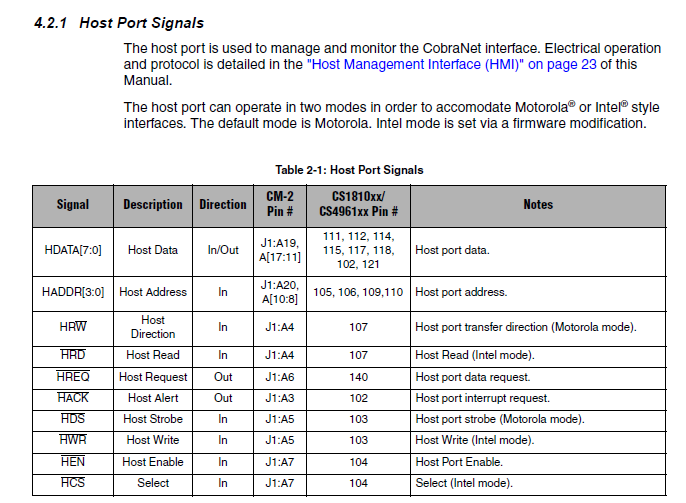

Hello
I need to implement a motarola style parallel port for a CM-1 interface in an AM5728.
Could anyone please advise if there is any way to use the processors features to help implement this better/faster - otherwise I'll be doing a bit bashing interface.
Please see interface signals below.
Your help would be much appreciated :)
