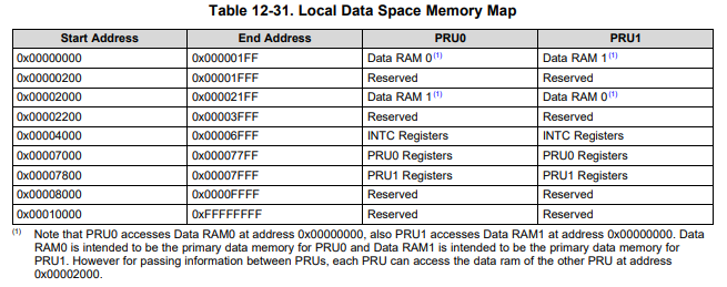

Can you please clarify how Data RAM 0  and Data RAM 1 for PRU0 and PRU1 in C6748?
Each is 512 bytes in size.  Each PRU has (or at least has access to) both Data RAM 0 and 1.  What are the limitations?  Are there actually three 512 byte RAM's and one of them is shared between the PRU's?
Thanks.
  • Peter,
    Please see the PRUSS Local Memory Map in Section 12.8.1.1 of the TMS320C6748 TRM (http://www.ti.com/lit/pdf/spruh79):
    As the note below the tables states: Data RAM 0 is meant to be the primary data memory for PRU0 and Data RAM 1 is meant to be the primary data memory for PRU1.
    Each PRU can access its primary data memory at address 0x00000000. So when PRU0 makes a local access to 0x00000000 it is accessing Data RAM 0 and when PRU1 makes a local access to 0x00000000 it is accessing Data RAM 1.
    If a PRU would like to access the Data RAM of the OTHER PRU then it would use address 0x00002000. For instance, PRU0 accessing Data RAM 1 would use 0x00002000 and PRU1 accessing Data RAM 0 would use address 0x00002000.
    There are two 512 byte memories.
