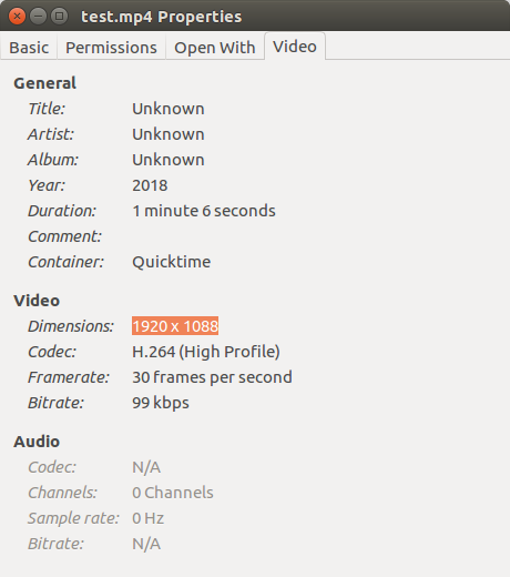

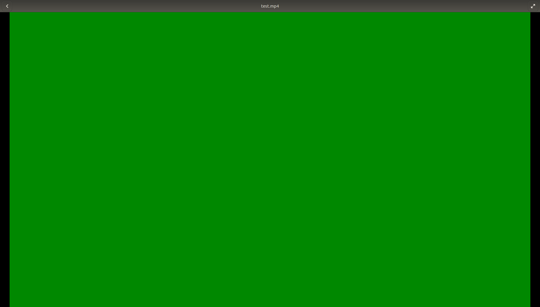

We use vision sdk 3.05, and now manage to enable GST encode/decode with both IPUMM and VSDK-Linux on IPU-2 according to https://e2e.ti.com/support/processors/f/791/p/778002/2880838#2880838.
I get the resultant mp4 file with the following cmd on the device.
gst-launch-1.0 videotestsrc pattern=snow num-buffers=1000 ! 'video/x-raw,format=(string)NV12,width=1920,height=1080,framerate=(fraction)30/1' ! ducatih264enc level=level-51 profile=high ! queue ! h264parse ! mp4mux ! filesink location=test.mp4
but when I playback the video in the PC, I notice something abnormal.
1.  the frame is solid colored, nothing as snow pattern.
2. the dimensions is 1920x1088 instead of 1920x1080.
Please help it, thanks a lot!

    Any further update about the issue, thanks!

  • Hi Sam,
    This is a Known-issue that mmap fails on the vmem exported memory. This issue is not rootcaused yet. GST encode with videtestsrc as src is not a tested usecase.
    In your current pipeline, videotestsrc will try to mmap the buffers to fill its pattern which are allocated by gst-encoder and mmap in gstreamer is failing.
    Your actual usecase where you feed the intermediate buffers to gst-encoder, should create a dmabuf fd out of it and and push the same to gst-encode.
    In this case this issue will not happen as mmap is not required.

    Thanks for your further explanation. Here is still some puzzle to figure out.
    1. the dimensions for the recorded mp4 is 1920x1088 instead of 1920x1080, how the abnormality takes place?

  • Hi Simon,
    1) Which stream analyzer you are using to view the stream properties. I use Elecard stream eye and VLC . Both show 1920x1080 as the resolution.

  • Hi Ram,
    for 1, It's my mistake, when I exam the properties in Windows, they are ok, but not so in Ubuntu.
    for 2, I will back to you when I have difficulty to implement the feature.
