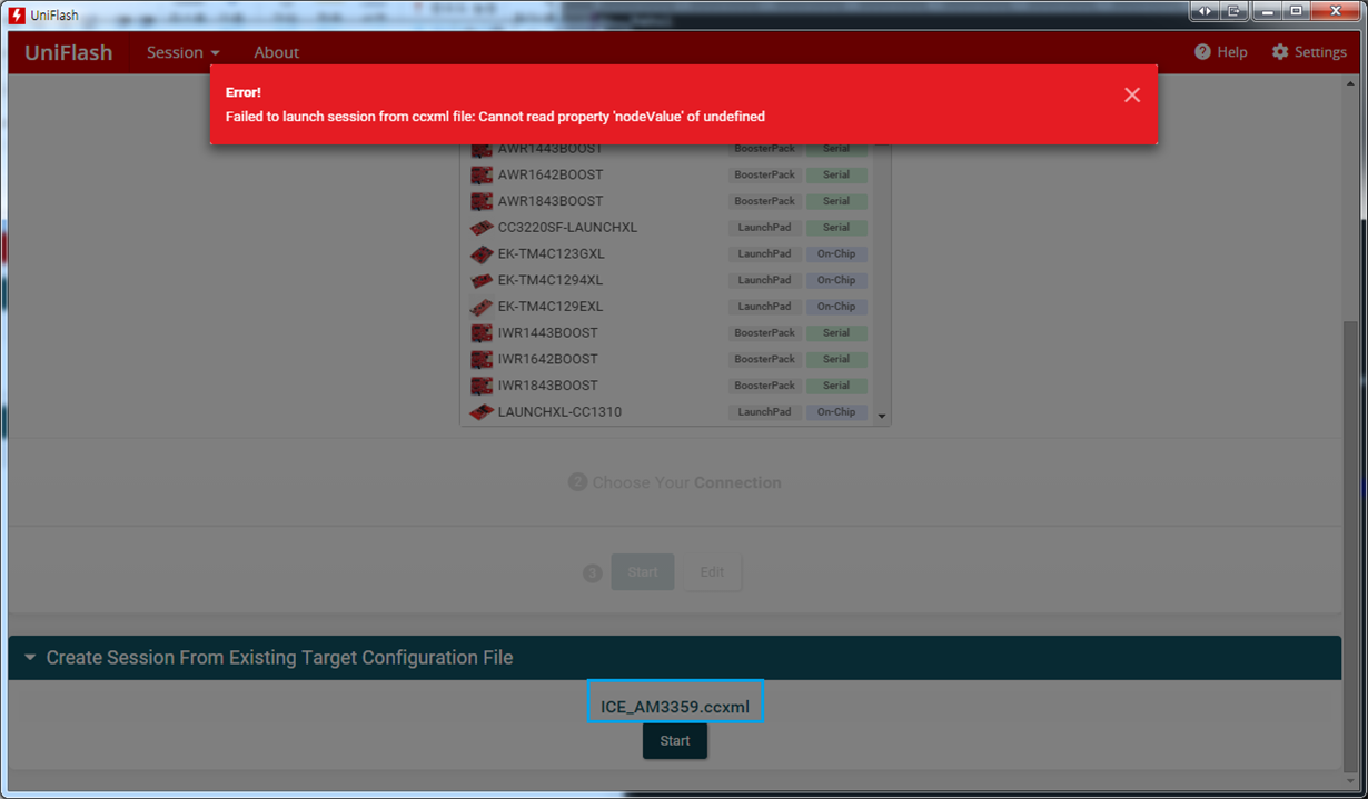

Hi. there
I have AM3359ICE (TMDSICE3359) and J-Link Debugger.

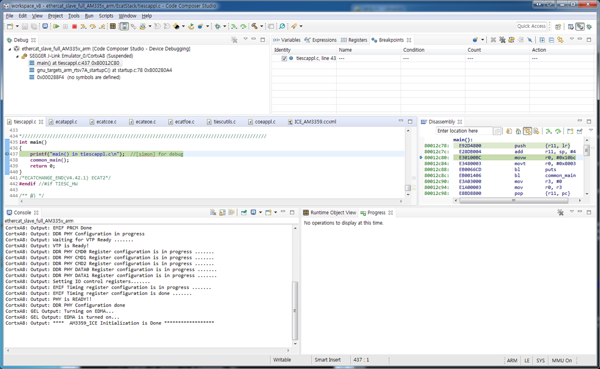

Debugging the AM3359 from CCS was successful.
I would like to flash "ethercat_slave_full_AM335x_arm.out" files to the AM3359 using J-Link Debugger.
How do I flash?
Environment :
  1) AM3359ICE2 Board Setting - Pin 2 & 3 shorted on J5.
  2) AM3359ICE2 Flash Device / Jtag

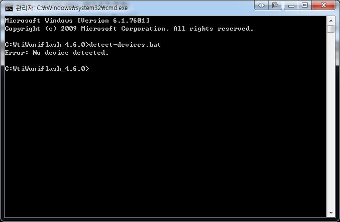

  3) I used Uniflash but could not detect the AM3359Ice2 device.
  4) Using ICE_AM3359.ccxml causes the following error:
Thank you in advance.

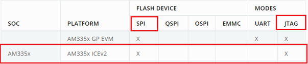

  • Simon,
    The steps for using JTAG approach to program flash is described in the Processor SDK RTOS developers guide here:
    software-dl.ti.com/.../index_board.html (REfer Steps section)
    It needs to be done from command line and not from the GUI. We are still working on getting the tool integrated in the GUI. Until then it needs to be excercised from command line

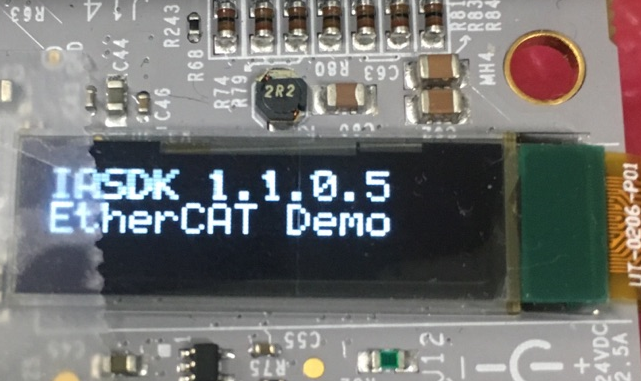

      1. Check LCD message before flash.
      2. Flash...
      3. Check LCD message after flash.
      But turn off the power and turn it on again, the LCD message will appear as the previous one.

  • Simon,
    Your understanding doesn`t seem to be correct. Programming flash on TI EVM platform using JTAG is a two step process.
    1. Run the dslite script using target configuration file (.ccxml) to load .out for the UART flashing binary and ensure that you see ping character "C" in the console. This can also be done using CCS IDE if you want. The .out to load in this step is located here:
    C:\ti\uniflash_4.5.0\processors\FlashWriter\icev2AM335x\uart_icev2AM335x_flash_programmer.out
    2. Then close the terminal and execute dslite command to send the flash image (_ti.bin or app ) over the UART interface so that it is flashed.
    You seem to be sending the .out for the ethercat application using dslite which only loads and runs the application over JTAG but doesn`t flash that to the serial flash.
    Please refer to the video that I have posted here that shows the process of programming flash using JTAG Approach. The video was created on AM65x platform but the same process applies to AM335x.
    e2e.ti.com/.../2833144
    Hope this helps.
    Rahul

      1-4. Check LCD Message => "IASDK 1.1.0.5 / EtherCAT Demo"

      3-1. Connect J-Link

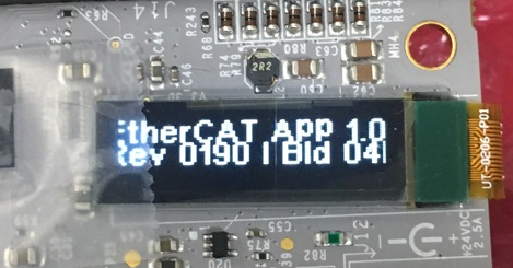

      3-2. Power On AM3359ICE2
      3-3. Run Debug
      3-4. Check LCD Message => "EtherCAT APP 1.0.7 / Rev 0190|Bld 04EE|"
      3-5. Power Off AM3359ICE2

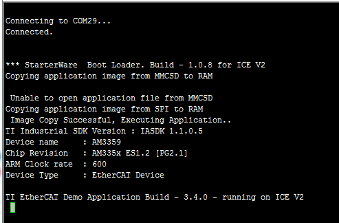

      4-4. Power On AM3359ICE2
      4-7. Check Hyper Terminal
      4-8. Close hyper Terminal

    BAsed on your log provided in step 4, it appears that on power cycle there is a image that is booting from SD/MMC . Can you please take the MMC/SD card out from slot J16 from the boot of the HW. If you don`t have a SD card in the slot then it possible that you have the wrong version of bootloader on the SPI flash. The Log on UART says copying application from MMCSD to RAM then it says copying from SPI to RAM. Notice the MMCSD boot loader and SPI boot loader binary is different. Check the file name of the bootloader file you used from the folder :
    pdk_am335x_1_0_13\packages\ti\starterware\binary\bootloader\bin\am335x-evm\gcc
    • bootloader_boot_mcspi_a8host_release_ti.bin   <-- This file is for booting from SPI flash
    • bootloader_boot_mmcsd_a8host_release_ti.bin <--this is file for booting from MMCSD
    To get a clean environment, I would erase the SPI flash using the instructions here and start fresh.
    http://processors.wiki.ti.com/index.php/AM335x_ICEv2_flash_erase
    Ensure after SPI is erased nothing is booting from flash and then try to load the uart_icev2AM335x_flash_programmer.out
