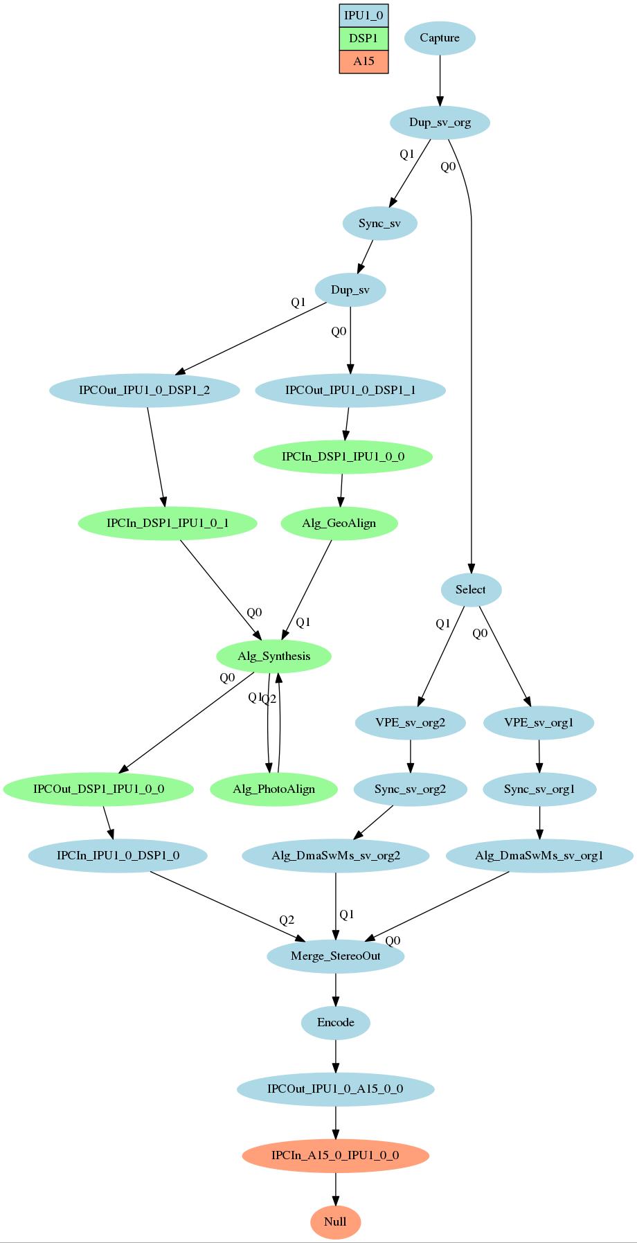

 on lvdsVipSurroundViewStandalone,I want to encode 4 raw video data and 1 spliced video data into a .H264 file and store it on the hard disk. If the original 4 channel video is 520*440,
 it is feasible to save it to the hard disk.
if Change the VPE output from 520*440 to 1280*720 on lvdsVipSurroundViewStandalone, the following problem occurs
