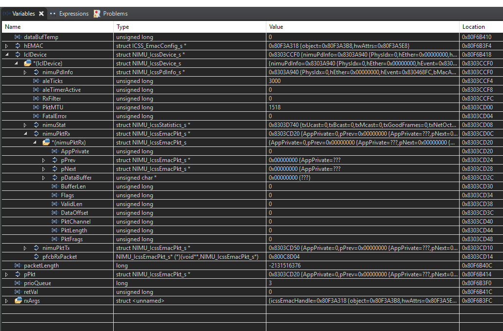

When NIMU_ICSS_interruptInit() is called, interrupt is triggered and post rxSemaphore. EmacOsRxTask then call ICSS_EmacPollPkt(). ICSS_EmacPollPkt() call -> NIMU_ICSS_interruptRx() -> NIMU_ICSS_rxServiceCheck().
In NIMU_ICSS_rxServiceCheck():
on line: 873 -> rxArgs.destAddress == 0!!!!!!
On line 874 jump on callBack -> RedRxPktGet but argument/address of destination address in NULL or some other undefined memory location, so on memcpy() it fail!
So why program fail, now I understand (Let me know if I'm wrong).
What I don't understand is why in NIMU_ICSS_open RX HWI enabled before "Initialize packet structure for Rx" function NIMU_ICSS_packetInit is called???
Function EnableEMACInterrupts is called after Rx buffer init, but how is possible that RX interrupt is allerady enabled???
Best Regards, Mare

    When the rxArgs.destAddress = 0, is pPkt->BufferLen also equal to 0?

  • Hi Garrett,
    as you can see in the upper post, all nimuPktRx members are 0.
    Upper suggested code will probably work (I call function to disable interrupt link an rx inside the interrupt function).
