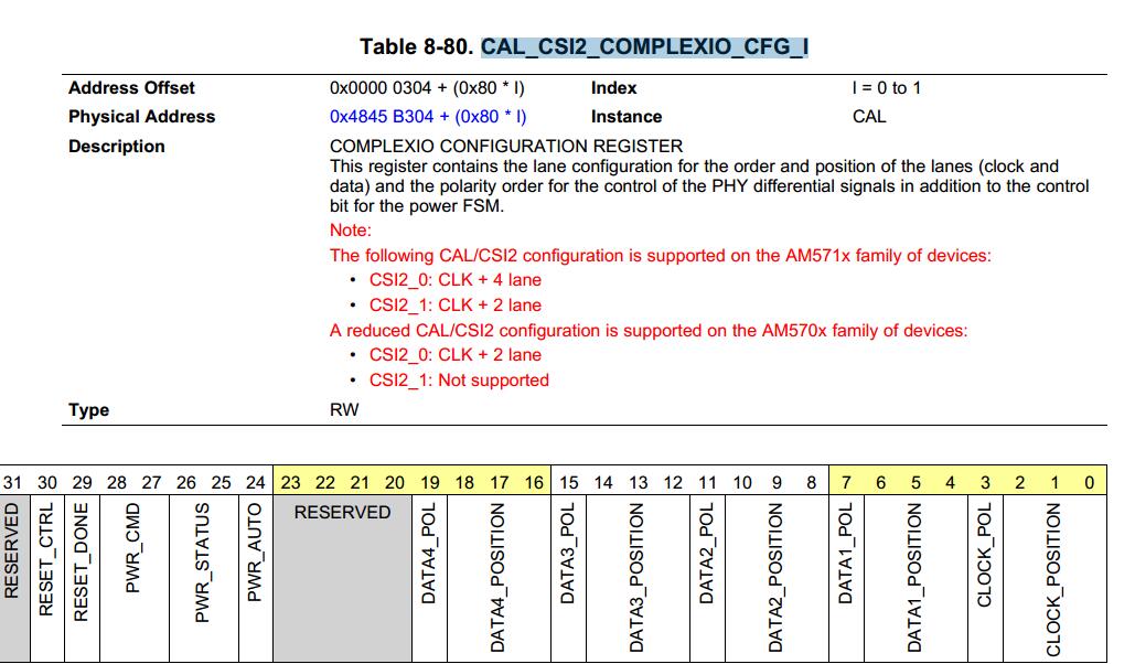

1、hardware design
2、Camera adaptation layer (CAL) mapping
.Set CAL_CSI2_COMPLEXIO_CFG_l[10:8] DATA2_POSITION.
 Set CAL_CSI2_COMPLEXIO_CFG_l[6:4] DATA1_POSITION.
 Set CAL_CSI2_COMPLEXIO_CFG_l[2:0] CLOCK_POSITION.
3、Use the "devmem2" command to manipulate registers
Print the following erro:
root@am57xx-evm:~# devmem2 0x4845b384

    H/W module can only be accessed when its functional and is running.
    Most of TI driver follow runtime power management. CAL is one of those driver. Its register can only be access while the
    hardware is active, otherwise the functional is turned off and the register are not-accessible.
    To use devmem2 on CAL for instance, you would need to start a capture using your favorite application and while it is
    running and then you could access the registers using devmem2.
