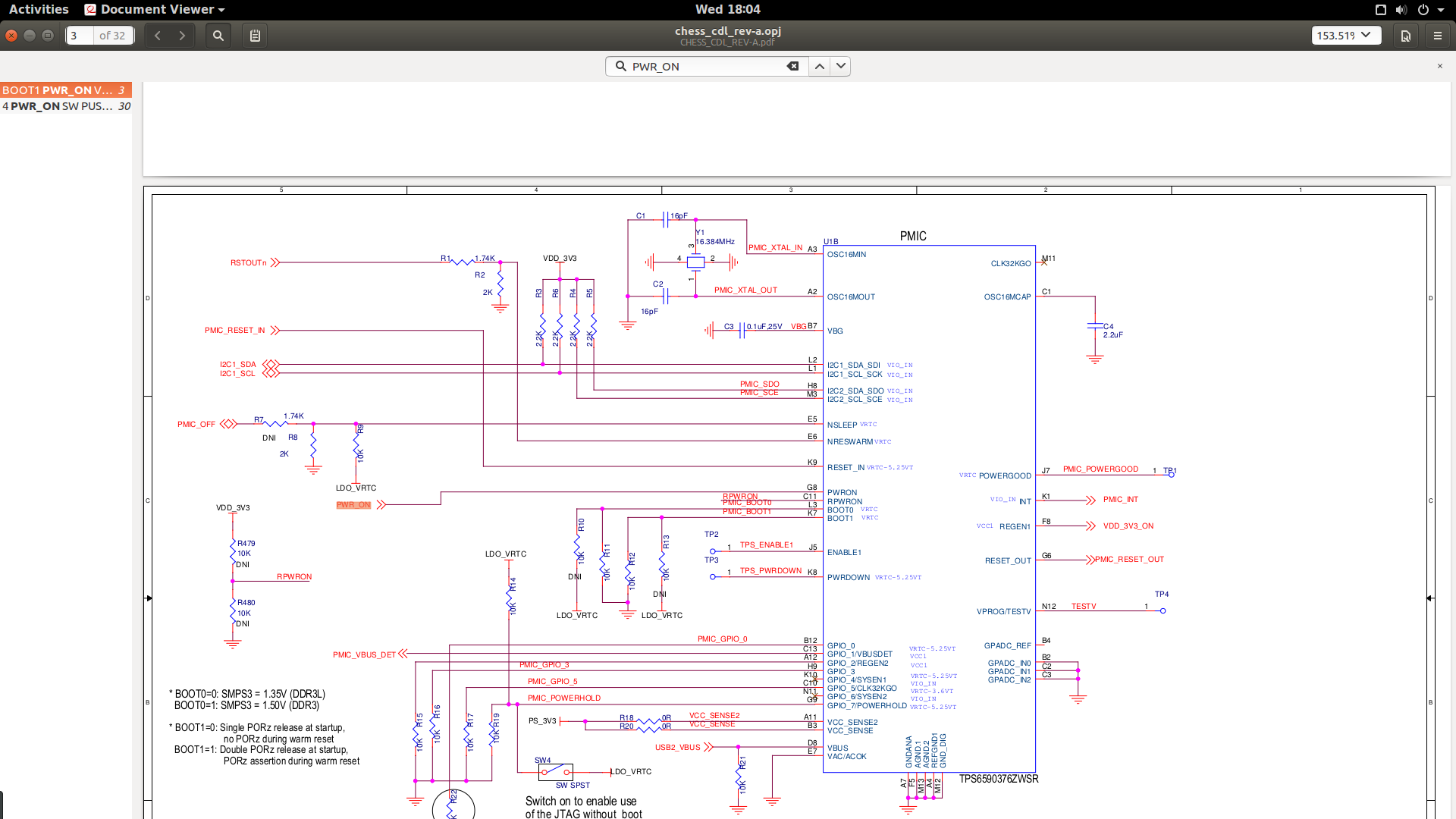

    I have verified the connections comparing to EVM design and Our Design. The PWRON pin from PMIC is directly connected to Push button.
    1 . Our board is directly powering ON without pressing S6 button. But in EVM S1 push button need to be pressed to power ON the board.

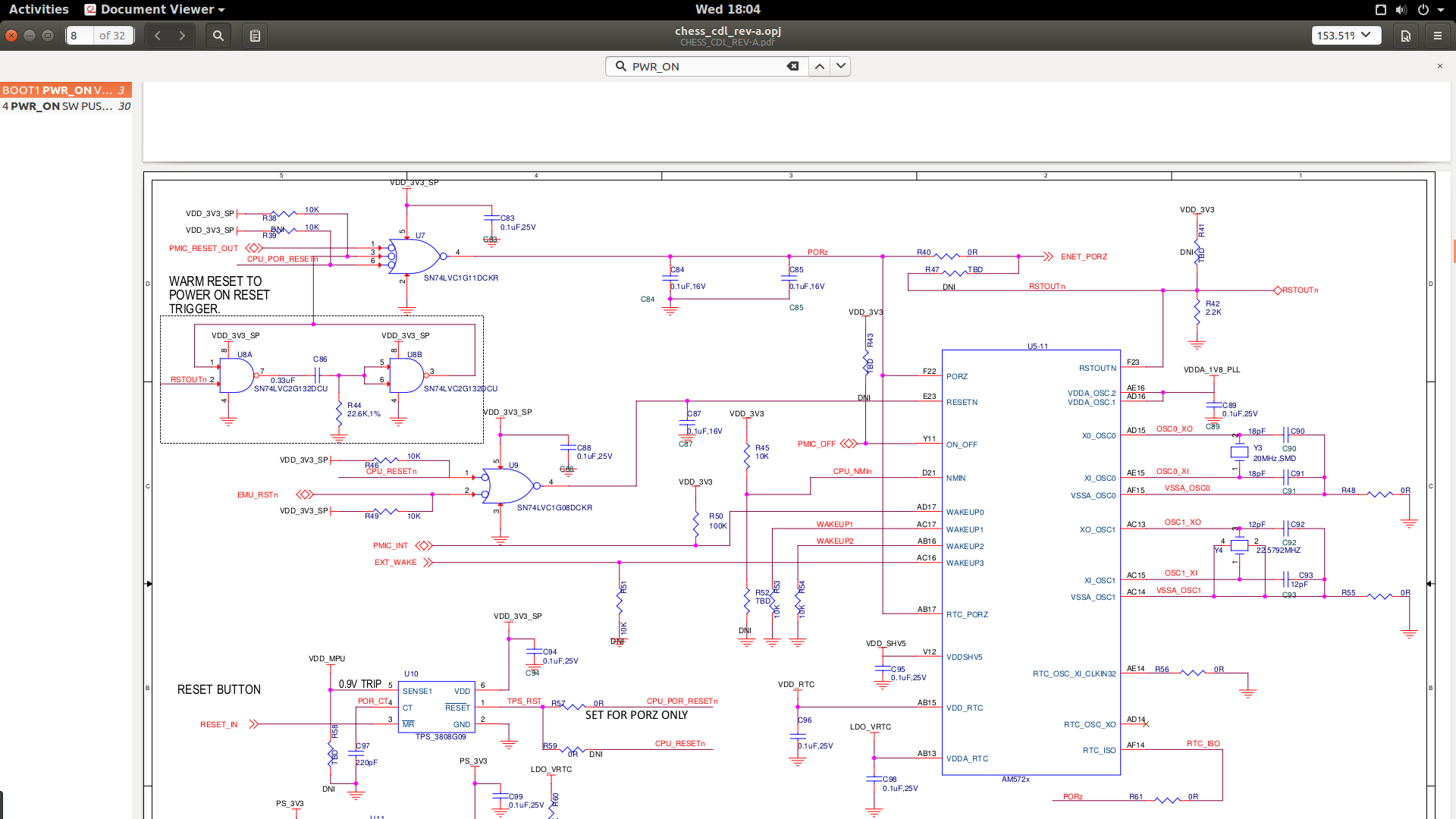

  • Hi Pavel,
    We have tried the i862, Its now working as per expectation same behaviour.
    I have shared the schematics, Please share the clue.
  • Karthikeyan,
    Can you please check your board with oscilloscope if you have valid signal on PMIC PWRON input pin, when you press the S6 button. You can also check how this signal should look like if you probe PMIC PWRON input pin of the AM572x EVM, when S1 button is pressed.
    Then you can check your board PMIC reset_out (AM572x PORZ in) pin signal and also compare it with AM572x EVM.
    Please let me know if you have valid and expected signals there. If not, then the issue is related to the PMIC component, not to AM572x device, and you need to ask/post your issue into the Power management forum, which is supporting the TI PMIC parts.

  • Hi Pavel,
    Ok , Let me check this and update you.
