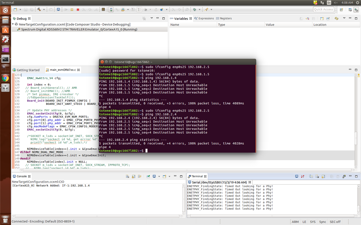

  • we are tying to run "NIMU_BasicExample_evmDRA75x_armExampleproject" application on DRA7xx (TDA2xx EVM) with ccs v7.
    while running the nimu application immediately we are getting run time exception every time and program terminates.

  • Hi Swati,
    This thread title says you are having issue on DRA72x EVM but the example you're trying to build is for DRA75x. Please build NIMU test app for DRA72x and it should run on the EVM without issue.
    Stephen
  • When we are trying with DRA75x NIMU application working fine but we are getting run time exception.
    DRA72x we are getting Ethernet timed out error.
  • Hi Swati,
    You are pinging 192.168.2.4 which is the wrong IP address. Please try pinging the correct IP address of your target: 192.168.1.4.
    Stephen

  • Swati,
    It's hard to say what is going on because the NIMU example does not use pthread API. It seems like you have modified the example in some way so we need to understand the changes you've made.
    Generally, a data abort means that the A15 is reading/writing memory which is inaccessible (e.g. through MMU, or bus fault, or otherwise). Specifically in this case, DFSR indicates that its a first-level MMU translation error caused by a write access. The LR indicates the address which the error was generated
    Perhaps you are dereferencing a bad pointer. Do you know what is happening at the LR address?
    Stephen

    NIMU_log("netOpenHook: SYS/BIOS Ethernet/IP (CPSW) Sample application, EVM IP address 2: %s\n", ip2Addr);
    #endif
    SOCKET m_lsds = socket(AF_INET, SOCK_STREAM, IPPROTO_TCP);
    NIMU_log("sockect id %d",m_lsds);
    But socket call always return -1.
    1.Is socket() calling is in right place??
    2.With NIMU ping application can we call socket API
    3.our aim is to create client server application using tcp/ip ,Can we use NIMU application as base??
    4 we are using TDA2xx evm (DRA7XX ) board ,any sample tcp/ip client server application with configuration file available or is there any way to generate the configuration file for this hardware .
