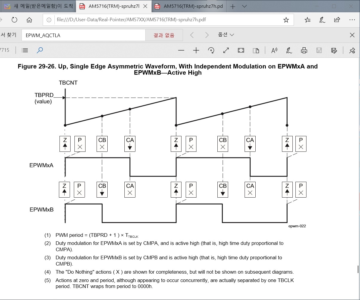

I would like to setup ePWM for Up, Single Edge Asymmetric Wave form with Independent Modulation on EPWMxA and EPWMxB as below diagrams.
Are there examples for this operation ??
