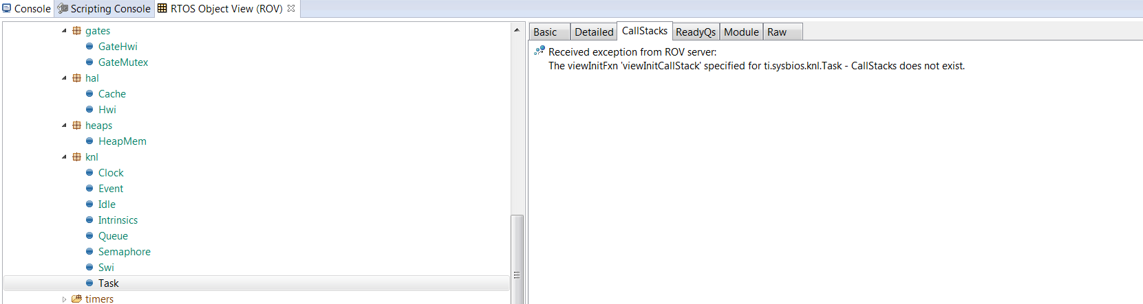

I was debugging on the issue when one of my high priority task was blocked and low priority task was running.
I can see the task state using RTOS Object View(ROV). I also know that the task was blocked by for example Event:0x123456.
I would like to find out more about the event which is blocking my high priority task. Can I know how can I see the stack of my high priority task so that I can tell if it is because of Hwi, Swi or semaphore or some external event from some other modules.

  • Thank you for your reply. I tried to build the BIOS.libType = BIOS.LibType_Debug.
    But, unfortunately, I cannot see the Callstacks and got this error from ROVserver.
    I think if I can see the Callstacks. I would have some clue on which event is blocking my higher priority task. Any idea how to fix it?
    I have my doubt that the lower priority task is using memcpy to copy some data. Do you think memcpy is using some Hwi which disables the Higher priority task from preempt lower prior task?

  • Hi Myat,
    We have a known issue with Callstack with unconstructed Task objects. ROV finds Task_Structs and displays them in ROV. If a Task_construct has not been done on the Task_Struct, most views state something like "Uninitialized Task object". For the CallStacks, it freezes instead:( We have fixed it in a future release. You can refer to this thread to get a work-around: e2e.ti.com/.../2845514
