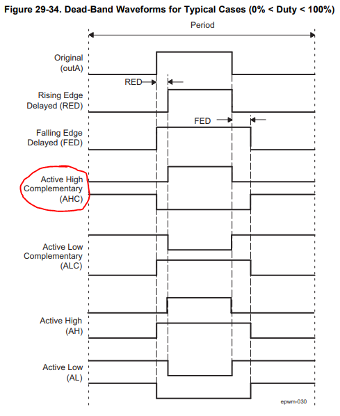

    You should be able to use the A and B signals of one ePWM to generate the complementary pair that I think you are trying to achieve. The ePWM peripheral should be able to take a duty cycle for the A signal and then use that and the deadband information to create the complementary B signal for you.
    The TRM is our best source of information for the PWMs and has a few 'Waveforms for Common ePWM Configurations'. Figure 29-30 in section 29.2.2.5.4 of the TRM (www.ti.com/.../spruhz6) should be very close to what you are looking for. In this configuration you have two options:
    1) Create CMPA and CMPB values manually that will add the deadband you desire between the complementary signals
    2) Use the Deadband module to create the EPWMxB signal for you based on the CMPA value and the RED and FED values

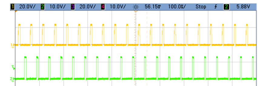

    Below is Required Pulse: Both channels are properly sync that am not able to achieve in mine case.
    Also not able to get how to calculate value for CompA & CompB, Right now am using same value for both with formula mention above.

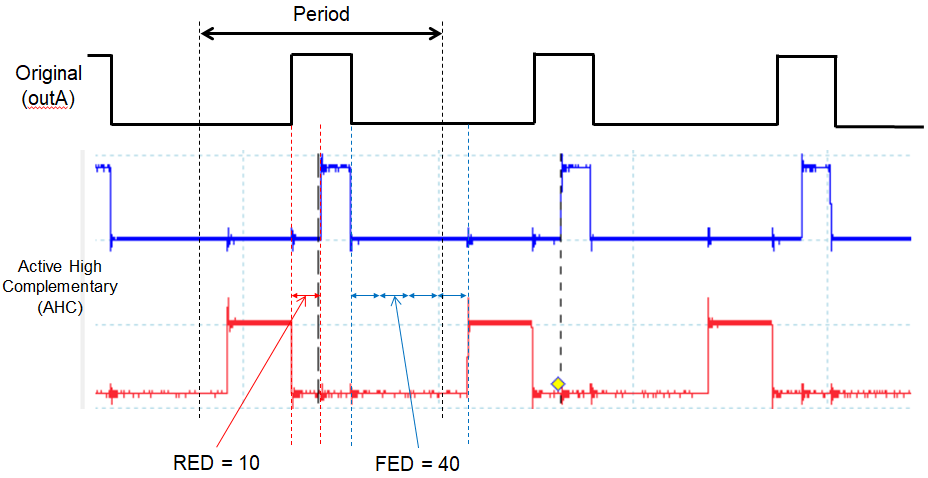

  • Akash,
    From your settings, you have chosen that EPWMxA (from the action-qualifier) is the source for both the falling-edge and rising-edge delay ( CSL_EPWM_DB_IN_MODE_A_RED_A_FED).
    You are using Active High Complementary polarity (CSL_EPWM_DB_POL_SEL_ACTV_HIGH_COMPLEMENTARY)
    You have also chosen that dead-band should be fully enabled for both rising edge on EPWMxA and falling edge on EPWMxB (CSL_EPWM_DB_OUT_MODE_A_RED_B_FED)
    This means that your output signals will only be based on the CMPA value (EPWMxB will be created based on CMPA and the RED/FED values) and it will match the Active High Complementary example from Figure 29-34 in the TRM:
    I have taken your scope capture and marked it up in the same way as the TRM diagram to show you:
    You can see what your original signal would like like without deadband at the top, and then I've marked the RED delay (10) and the FED delay (40).
    Your FED delay being so large is actually making your complementary signal spill over into the next period.
    A different option to achieve your goal would be to not use the deadband module, and instead program a complementary value for the CMPB event that would create the EPWMxB signal.

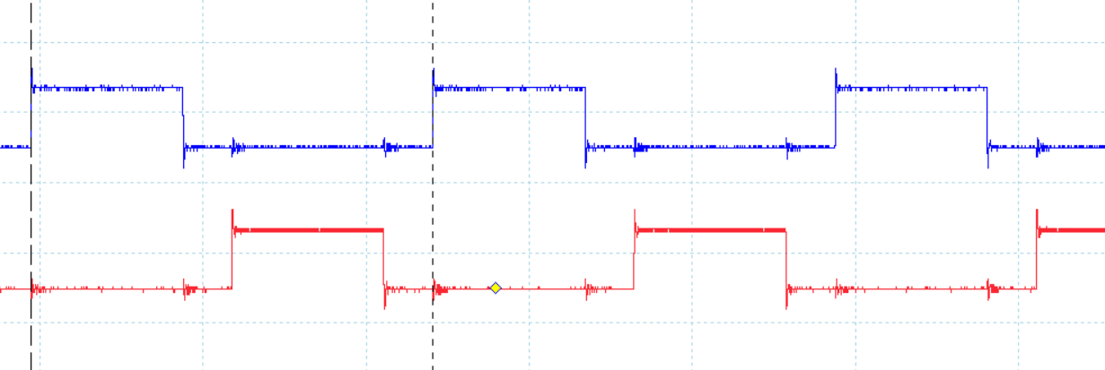

    Result pulse generated using above settings:
    Also i need to use COMPB value during counter compare configuration to generate above pulse. So am little bit confused regarding configuration. My aim is to generate complementary  pulse using DB between 0 to 50% duty cycle.

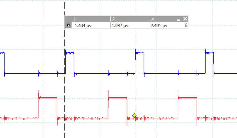

  • Hi Jason,
    Am able to control required PWM signal's A & B using dead-band feature with respect to frequency and duty-cycle. Just want to add 180 degree phase shift between them, but unable to do that. Can i know how to apply phase shift of 180 degree between two pulse.
