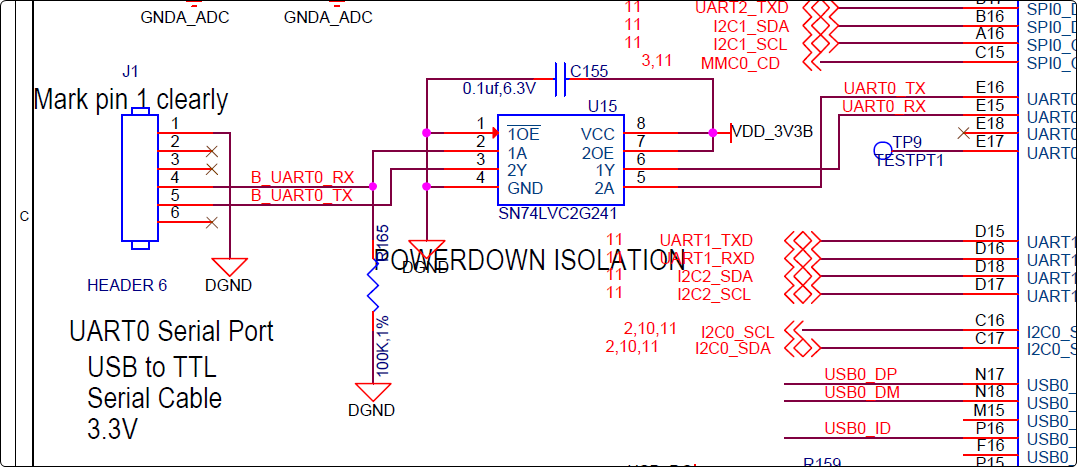

  • Can you use a different PC for the console? We need to figure out why your UART conflicts with your JTAG. Is it a software issue, eg are you connecting to a UART port that is required by CCS? Or do you have some kind of hardware conflict where the UART is trampling on ur JTAG chain?
  • Is it possible to use a Windows PC for the console?
    Absolutely.  In fact, that's usually how I do my work.  I use Tera Term in Windows (though I've seen other people use putty, etc.).  Most of the time I just SSH into my Linux box for doing builds, etc.
  • Okay cool. So I just tried using Tera Term on a separate PC and still go the same error. And then when I closed Tera Term it was able to connect. Does that mean there is some sort of conflict between UART and JTAG?
  • Yes, sounds like some kind of hardware issue. In general I would expect UART and JTAG to be fully independent. If you want to post some schematic snippets of your UART and JTAG I will take a look. Otherwise you will need to dig into it on your side to figure out what's happening.
  • I looked at the schematic but I didn't see anything that looks like the two are conflicting. The guy who did the PCB design is out of the office right now so I'm waiting for him to get back to ask him about this. Is this issue something that would prevent the board from booting or just prevent me from debugging?

    I also am attaching a couple snippets of the schematic so you can look at the UART and JTAG to see if anything looks out of the ordinary. (For the Debug port, we clipped pin 3 so that it is no longer connected to 3.3 V).
    schematic_snippets.zip
    This comment has me really confused:
    • Pin 3 is TDI, not the 3.3V pin.
    • Pin 6  (3rd pin on the "even" side) is normally the one that's clipped.  That's to ensure that you don't plug the JTAG header on backward.  Please double check your JTAG probe to make sure there's a corresponding "plug" in the hole for Pin 6 to enforce that you plug the header onto the board correctly.
    • Pin 5 is 3.3V.  That's the 3rd pin on the "odd" side.
    Can you clarify on your comment?  The 3.3V signal on Pin 5 (VTREF) is used by the JTAG probe to know if your board is powered up.  Otherwise it might damage the IC by driving signals into an unpowered device.  So you really need to have this signal...  Which JTAG probe are you using?  XDS100v2?  XDS110, etc.?
  • Looking at your UART connection, do you have a buffer anywhere? It looks like UART0 connects directly to some kind of header. Is that correct? If that is the case, do you have some kind of external logic that prevents you from driving signals into the UART when the board is unpowered? Normally UART signals are high, so if you have 3.3V signals sitting on the UART pins while the AM437x is turned off, you're going to destroy those pins...
  • Yes, it connects directly to a header. And that's the header I was referring to when I said that we clipped pin 3.
  • Pin 6 is clipped on the JTAG header like normal, but we clipped pin 3 on the UART header as well because it was not clipped at first, and when we connected to the serial cable it caused the processor to get hot.
  • Oh, sorry, when you said "Debug port" I was thinking the JTAG.  I see the UART is labeled "Debug Port".  Now I'm with you...  This UART port looks problematic to me.  I think you're going to end up damaging a lot of boards this way.  In fact, you may have already damaged some of your boards.  In most designs you'll see that we use a sn74lvc2g241 to provide isolation in the case that the processor is powered down.  Here's an example from the BeagleBone Black:
  • Okay, I see... So how serious of a problem is this?
