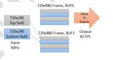

We are getting data from 4 CVBS cameras(720x480)  connected to a ISL79987 Decoder to CSI2_PHY2 of TDA2PX.
Now the data received  has the video data that has an even frame field followed by an odd frame field  of 720x240 resolution.
To get the correct frame for processing , each ODD and EVEN frame field needs to be  merged  to generate  720x480 resolution frame buffer. Can anyone please suggest how to achieve this in TDA2PX.
Below is the representation of the operation which needs to be performed on captured frame field
