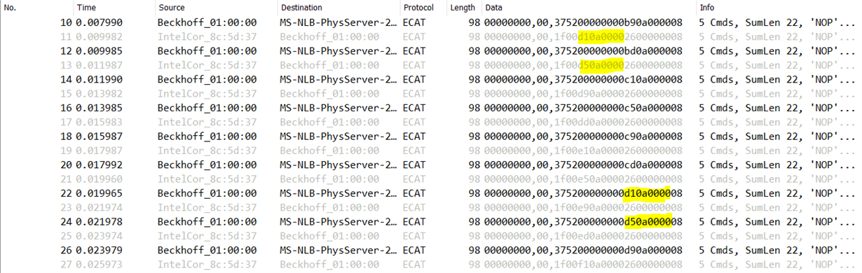

    I'm using TwinCAT in run mode with DC enabled and I'm monitoring the frames using wireshark. And yes, we have a GPIO toggling like mechanism, but using more bits. The master writes the register outputs and increases it by one on every cycle. This value is copied inside the sitara in a input register.
    See what we are seeing on wireshark, I think it is easier to understand:
    The grey rows belong to the data that goes from master to slave. Black rows belong to data that goes from slave to master. As you can see data is correctly copied on every ethercat bus cycle but the transmission to the slave is delayed 5 cycles. In this example the ethercat bus rate is 2 ms. If I set the cycle to 0.5 ms instead, the number of cycles are exactly the same. So it looks like it is not a timing issue.

    Can you try to use PLC to ensure timing consistency for the measurement? Also using process data memory instead of register, we don't see such big latency cycles.

    I'm sure the issue is not from the master because we are doing the exactly same test with other Ethercat Slave Controllers and we are seeing better results than the implementation on Sitara AM3357. We are already using process data, the "registers" are mapped there.
    Could you share how are you executing the test? How many cycles of latency do you see in your test?
    We would like to understand how sitara is managing the data to see if we could improve this somehow.
  • We use frame timestamp to calculate the latency. Below is our test procedure and result:
    1) We have three PDOs,
    a. Master_timestamp -> Current timestamp of PLC. Sent from PLC to slave with every frame
    b. Slave_timestamp -> Current timestamp of Slave. Sent from Slave to PLC with every frame
    c. Master_to_Slave_delay -> Slave reads the master_timestamp variable in application and writes back (Slave_timestamp – Master_timestamp) value. This gives the delay from Master to Slave. Sent from Slave to PLC with every frame.
    2) A task runs in PLC every cycle which checks the maximum values of
    a. Master_to_Slave_delay
    b. (Master_current_timestamp – Slave_timestamp)
    i. This is the Slave_to_Master_delay
    This is all assuming the Slave is running in DC mode. And readings we get for 1ms cycle time is
    1) PLC to Slave -> ~0.3 cycle
    2) Slave to PLC -> ~1.7 cycles
    Regards, Garrett

    On our last test we have been able to reproduce similar results than yours (2 cycles on wireshark but at 2ms ). So good news. My last question about this topics:
    • If you increase/decrease the cycle time of the EtherCAT network to for example 500 us or 2 ms in your test, what results you obtain in cycles?

  • Hi
    I checked internally that we don't really have the latency data set with cycle time 500us or 2ms, but we think it should be close to ~0.3 cycle/~1.7 cycle as well.
    Garrett
