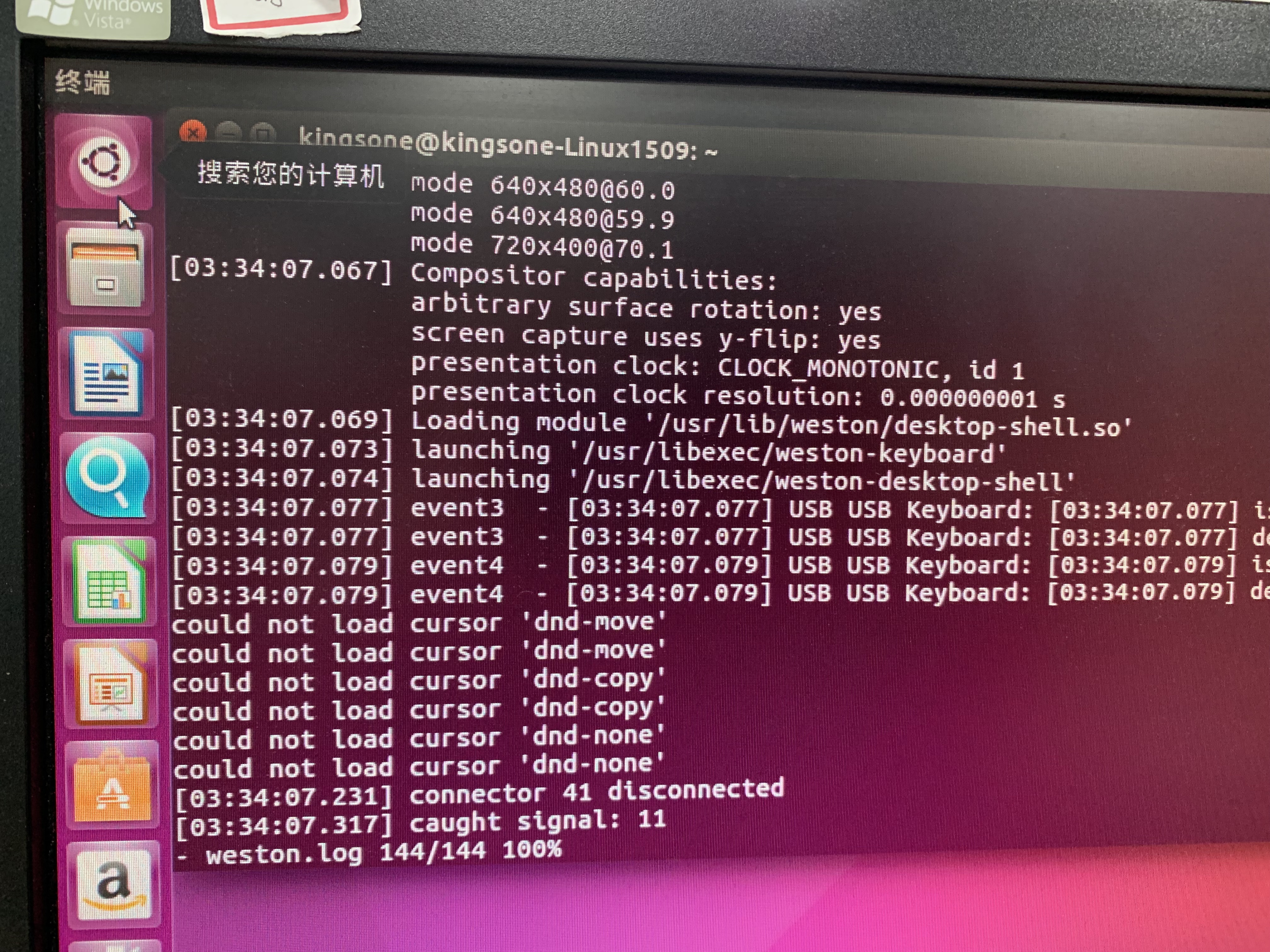

  • Hi Margarita,
    Thank you for your answer.
    I have fixed the camera module with screws now.
    when start the board, the screen display the followed information always.
    As showed in the screen. I open the file /var/log/weston, and the last lines is that:
    When run the command ls /dev/video*, the result is also /dev/video0 /dev/video10 /dev/video11.
    Run the command dmesg | grep mt9t, the result is also as before.
    Thank you for your help.

    1. Regarding weston:
    Please try with the default PSDK. You could try /etc/init.d/weston start . If still is not working please share the full log in txt file.
    2. Regarding camera issue:
    This [ 7.970929] mt9t11x 4-003c: Product ID error ffffff87 error indicates that your sensor board has either gone bad or the sensor has turned loose. You can try snapping the sensor board tightly to the base board (highlighted in red oval in below image) and see if it fixes the issue. If not, you will need to get another sensor board.
    Please try to remove and connect it again.
    Please take a look into these threads:
    e2e.ti.com/.../1932846
    e2e.ti.com/.../596177
    If you have ov10635 based sensor board or another camera module  with mt9t11x  , you could try with it?
    BR
    Margarita
  • hi Margarita,
    Now I have deleted the sentence fdtfile=am57xx-evm-reva3-cam-mt9t111.dtb in file uEnv.txt, and I think the default PSDK is valid.
    But the question is still exist. When I run the /etc/init.d/weston start. The result is as followed:
    Date: 2018-12-16 UTC
    [03:53:48.777] weston 2.0.0
    http://wayland.freedesktop.org
    Bug reports to: bugs.freedesktop.org/enter_bug.cgi
    Build: 1.99.94-2-g4c4f13d configure.ac: bump to version 2.0.0 for the official release (2017-02-24 16:19:03 -0800
    [03:53:48.777] Command line: weston start
    [03:53:48.777] OS: Linux, 4.14.79-gbde58ab01e, #1 SMP PREEMPT Thu Dec 20 04:51:24 UTC 2018, armv7l
    [03:53:48.777] Using config file '/etc//weston.ini'
    [03:53:48.778] Output repaint window is 7 ms maximum.
    [03:53:48.778] Loading module '/usr/lib/libweston-2/wayland-backend.so'
    [03:53:48.778] Failed to load module: /usr/lib/libweston-2/wayland-backend.so: cannot open shared object file: No such file or d
    irectory
    [03:53:48.778] fatal: failed to create compositor backend
    The full log of /var/log/weston.log is :

    [03:34:06.938] Compositor capabilities:
    arbitrary surface rotation: yes
    screen capture uses y-flip: yes
    presentation clock: CLOCK_MONOTONIC, id 1
    presentation clock resolution: 0.000000001 s
    [03:34:06.942] Loading module '/usr/lib/weston/desktop-shell.so'
    [03:34:06.958] launching '/usr/libexec/weston-keyboard'
    [03:34:06.960] launching '/usr/libexec/weston-desktop-shell'
    [03:34:06.963] event2 - [03:34:06.963] SIGMACHIP Usb Mouse: [03:34:06.963] is tagged by udev as: Mouse
    [03:34:06.963] event2 - [03:34:06.963] SIGMACHIP Usb Mouse: [03:34:06.963] device is a pointer
    [03:34:06.966] event3 - [03:34:06.966] USB USB Keyboard: [03:34:06.966] is tagged by udev as: Keyboard
    [03:34:06.966] event3 - [03:34:06.966] USB USB Keyboard: [03:34:06.967] device is a keyboard
    [03:34:06.969] event4 - [03:34:06.969] USB USB Keyboard: [03:34:06.969] is tagged by udev as: Keyboard
    [03:34:06.969] event4 - [03:34:06.969] USB USB Keyboard: [03:34:06.969] device is a keyboard
    could not load cursor 'dnd-move'
    could not load cursor 'dnd-copy'
    could not load cursor 'dnd-none'
    [03:34:07.131] connector 41 disconnected
    [03:34:07.212] caught signal: 11
    About the camera module, I have tried one more, is also wrong. I will try again.
    Thank you for your patience.
    Could you try:
    weston --tty=1 --backend=drm-backend.so
    Here is the link to graphics and display guide:
    software-dl.ti.com/.../Foundational_Components_Graphics.html
    BR
    Margarita
