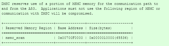

  • What is the purpose of MSMC3_DMSC reserved area? I couldn't find that region anywhere in the documentation.

    Having said that let me explain the reserved memory in the MSMC. As you know on this device architecture, DMSC/Cortex M3 is the power management and resource management master core and the other cores setup proxy channels using navigator subsystem for messaging with the M3. The region reserved in memory is for these secure proxy structure definition that are used for messaging with SYSFW running on the M3. The MSMC_NOCACHE is used to configure the cache for buffers backing this secure proxy and ring memory. You can find the reference to this MSMC usage in the TISCI USer guide for the SYSFW here:
    We planned to add this as a in integration usage note but It looks like the integration document notes are waiting to be merged with Processor SDK RTOS documentation. Here is a preview of the documentation:
    Configuration of R5F cache shouldn`t impact this last 56KB region. If you are application also uses A53 to send messages to M3 then using this region can impact the system/.  In the longer term, we plan you add an API so cores can query the MSMC usage and also move the MSMC_DMSC region to the end of the MSMC region so it is not in the middle of the MSMC range.
    Let me check on the MSMC usage in the USB driver and the board configuration and get back to you but I suspect that since the MSMC is used by A53 applications to talk to DMSC, the R5F developers don`t consider it to be reserved.
