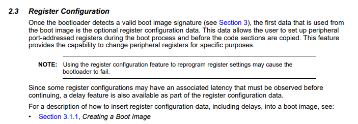

  • Hi again,
    as I can see in both .bin images register configuration count is 0000.
    0000 .word 9AAh ; signature
    0002 .long 19974h ; entry point 00019974 (00011974 on other image)
    0006 .word 0 ; register configuration count 0000 ???
    0008 .word 36h ; Section 1 word count 0036h
    000A .long 8000h ; Destination address to load Section 1: 00008000
    This means that no registers are configured prior to executing the image and it can be a pretty good reason for the code to hang.
    BR
    Michail
  • Michail and Tsvetolin,
    Thank you for your investigative work.
    Within the actual program itself, I'm able to successfully initialize ESBR, GPIO, GPT, and the interrupts. Isn't it enough for the registers to be initialized within the program itself, or is it mandatory for the boot loader to initialize those peripherals?
    I'm willing to give this solution a try but I have never used the register configuration feature before and would probably cause the bootloader to fail if I tried. Could you provide a reference or step-by-step guide for how to do this?
    Eddie

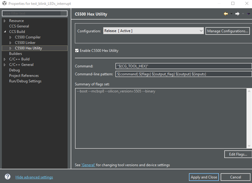

  • Michail,
    The settings I used can be seen below:
    I did my best to follow the recommended commands from SPRABL7D
    Eddie

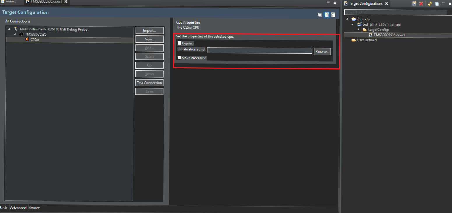

  • Hi again,
    I think before testing with another options for hex55 it is good to clarify something. Generally if an application is intended to work standalone (as from I2C eeprom) it should also work through xds110 without including .GEL file for the particular chip. Did you already tested to run your app through emulator with no .GEL specified?
    BR
    Michail
  • Michail,
    I believe that I am already driving the XDS110 without a .GEL file, but please tell me if I'm wrong:
    Eddie
  • same problem. without gel file, it's working well. But after eeprom boot, it doesn't work

  • Hello Eddie,
    as I see HEX55 utility command line does not include -serial8 option. Can you test replacing the -mcbsp8 with it to check if there will be any difference?
    Michail
  • Michail,
    I gave your suggestion a try. Unfortunately the same issue persists.
    Eddie
