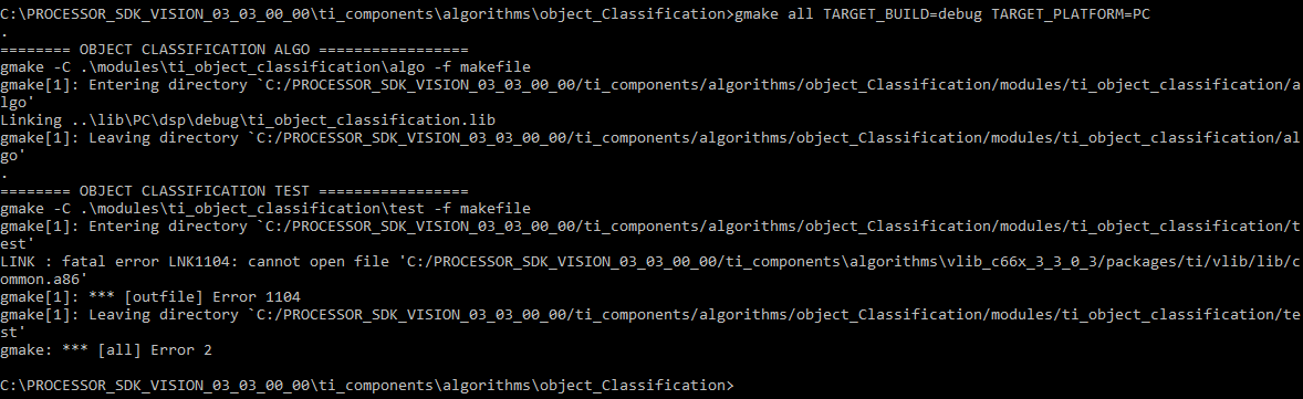

I followed all the instructions mentioned in ObjectClassification_DSP_UserGuide.pdf to build the Object Classification Code '200.V.OC.C66XSRC.00.02' for Host Emulation on PC but its not compiling!
There is a linker error, as shown in the figure below:
The common.a86 file is missing in the vlib_c66x_3_3_0_3 library!!
How can I compile the OC code for host emulation? Could someone help me solve this issue?

  • Hi Ganesh,
    you will need the VLIB package for host emulation which is part of VLIB source package (see chapter "3.5.2 Installing VLIB package for host emulation" in ObjectClassification_DSP_UserGuide.pd). You need to contact your local TI representative to get it.
    Yordan
    We got the source code from TI Field application Engg. We are now able to compile the Object Classification Source Code for Host Emulation.

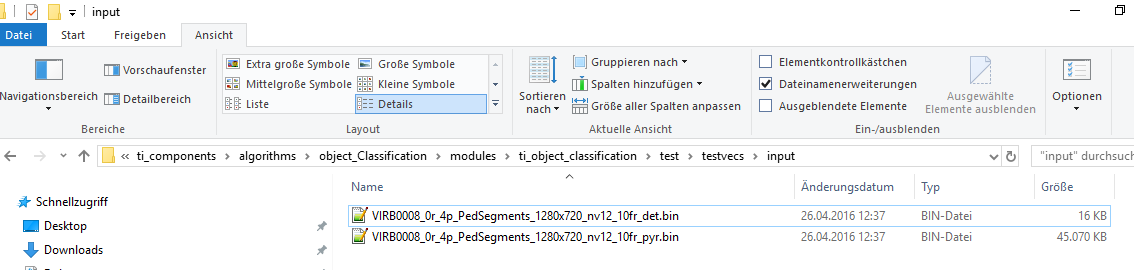

    In C:\PROCESSOR_SDK_VISION_03_03_00_00\ti_components\algorithms\object_Classification\modules\ti_object_classification\test\testvecs\input
    there are 2 sample input files:
    I guess VIRB0008_0r_4p_PedSegments_1280x720_nv12_10fr_det.bin is the ouput of the OD algorithm.
    What is VIRB0008_0r_4p_PedSegments_1280x720_nv12_10fr_pyr.bin ?  Is it output of EVE application for feature plane generation? If I have some .yuv images how can I generate this file?
    The OD algorithm also required output of FeaturePlane generation app as input.
    Is it same with the OC algorithm or is it different?

  • Hi Ganesh,
    The _pyr.bin file is the image pyramid file given EVE algorithm to construct HOG feature pyramid. This is provided in OD userguide section 4.6.2
