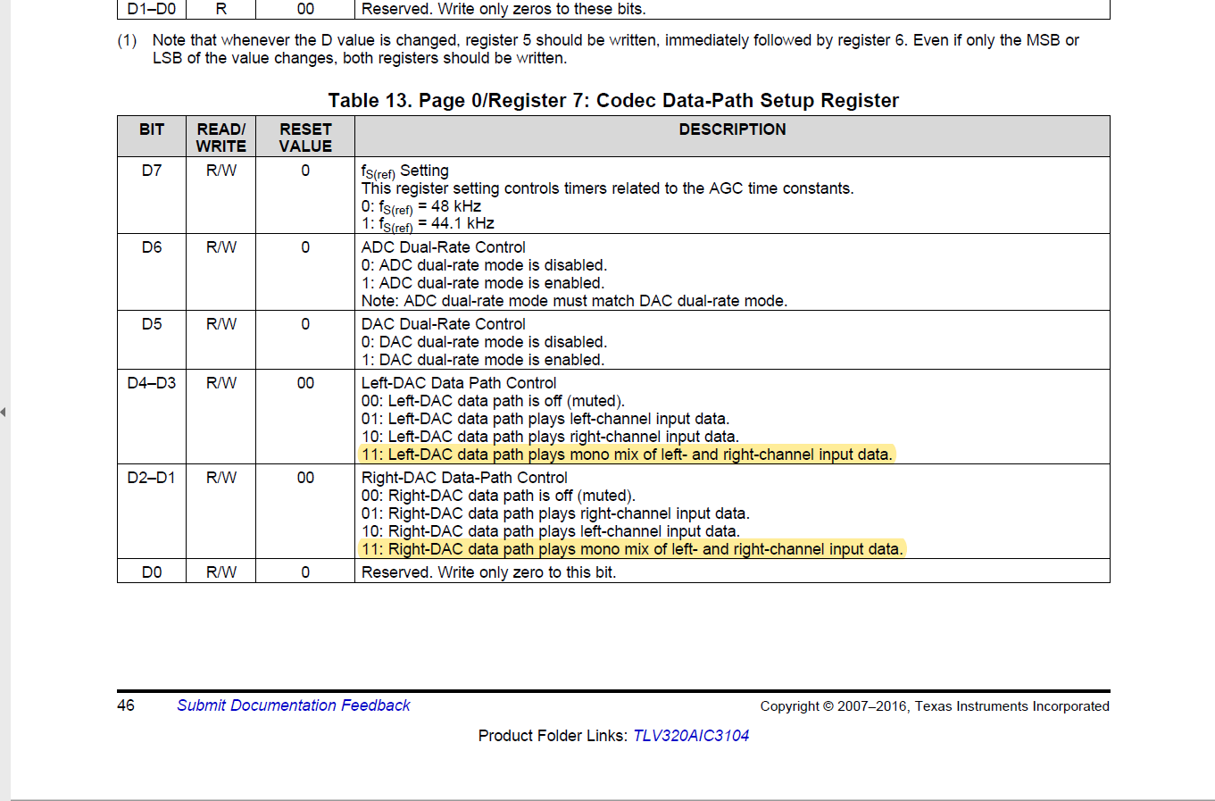

  • Pavel,
    I checked McASP signals and they look fine.
    How can I control LEFT-DAC and Right-DAC data path registers in my device tree?
    I would like to set the registers as in the highlighted part of the image below:

  • Pavel,
    I followed the provided link and was able to get audio on Line out, but I am trying to get mono on line out.
    For mono configurations, I posted the question on Audio forum and got the response to "set page 0 register 7 D3-D4 to '11'. This means that the left DAC channel is automatically a mono mix of the left and right data received on the I2S bus. "
    But I don't know where to set these settings. I looked up amixer but did not find any settings to change values on this register. I would really appreciate if you can help me out.

  • Pavel,
    I got it working!
    I found the settings to route Left-DAC to play mono mix in "linux-kernel/sound/soc/codecs/tlv320aic3x.c" and "linux-kernel/sound/soc/codecs/tlv320aic3x.h"
    On line 1103 in tlv320aic3x.c
    data = (LDAC2LCH | RDAC2RCH);
    changed it to
    data = ( LDAC2MONOMIX | RDAC2RCH);
    I recompiled the Kernel and I also saw in my amixer settings my 'Line DAC' was ON but 'Line' setting was off. So I also turned on 'Line' and got the audio on LEFT_LOP/M.
