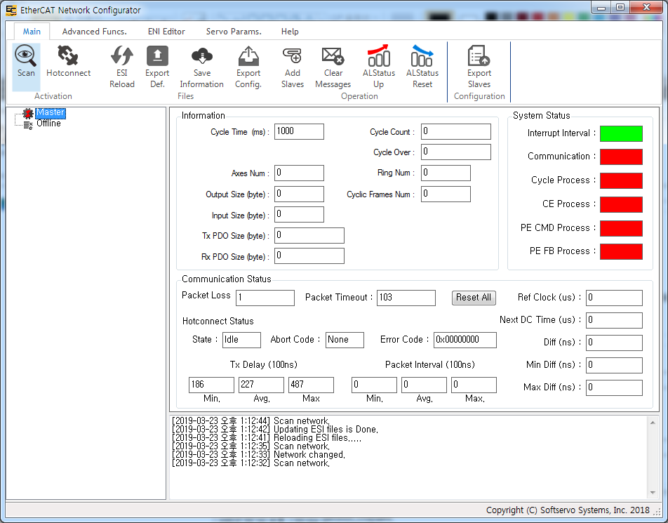

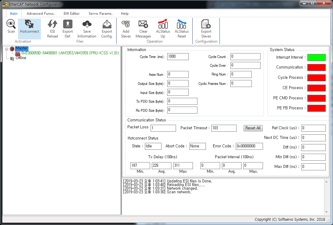

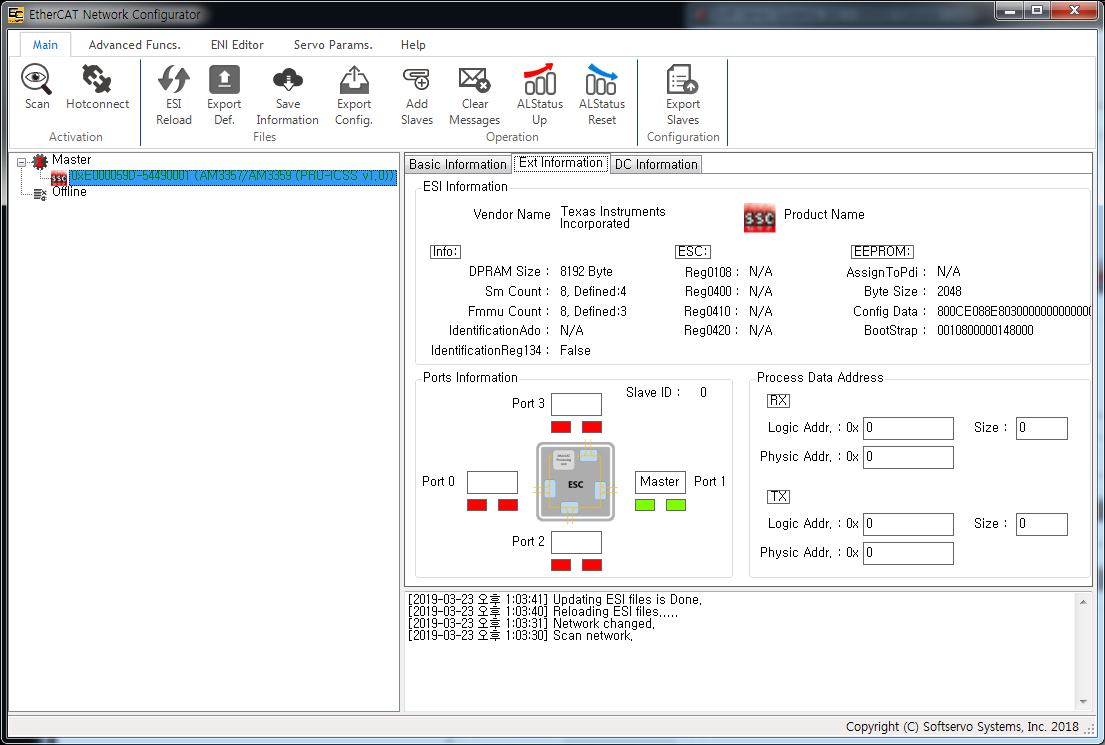

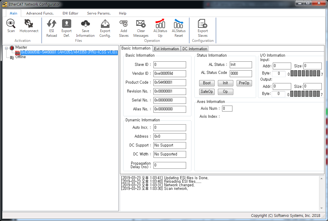

If you start debugging after connecting the master device to the AM3359ICE, the device can not be scanned.
If it is not in debug state, it scans the device normally.
Step.
   1. Connecting the master device to the AM3359ICE.
   2. Run EtherCAT Program on Master Computer.
   3. Connect J-Link.
   4. Power On AM3359ICE.
   5. Scan the AM3359ICE on EtherCAT Program.
   6. Check the scan results. => SCAN OK !!!
   7. Run CCS
   8. Build ehtercat_slave_full_AM335x_arm
   9. Run Debug
  10. Scan the AM3359ICE on EtherCAT Program.
  11. Check the scan results. => SCAN NG !!!

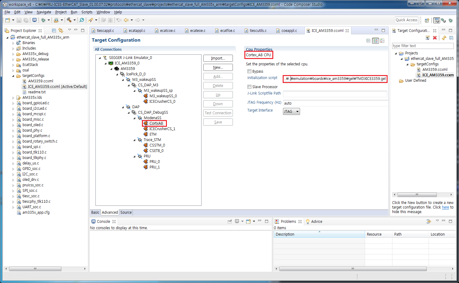

    There is an on-board xds100v2 debugger on AM3359 ICEv2, and if you create target configuration for the board, its GEL file will be automatically linked, emulation\boards\ice_am3359\gel\TMDXICE3359.gel. With the J-link debugger, are you using the same GEL file for board initialization?

    1. The GEL file used in J-Link is as follows.
        c:\ti\ccsv8\ccs_base\emulation\boards\ice_am3359\gel\TMDXICE3359.gel

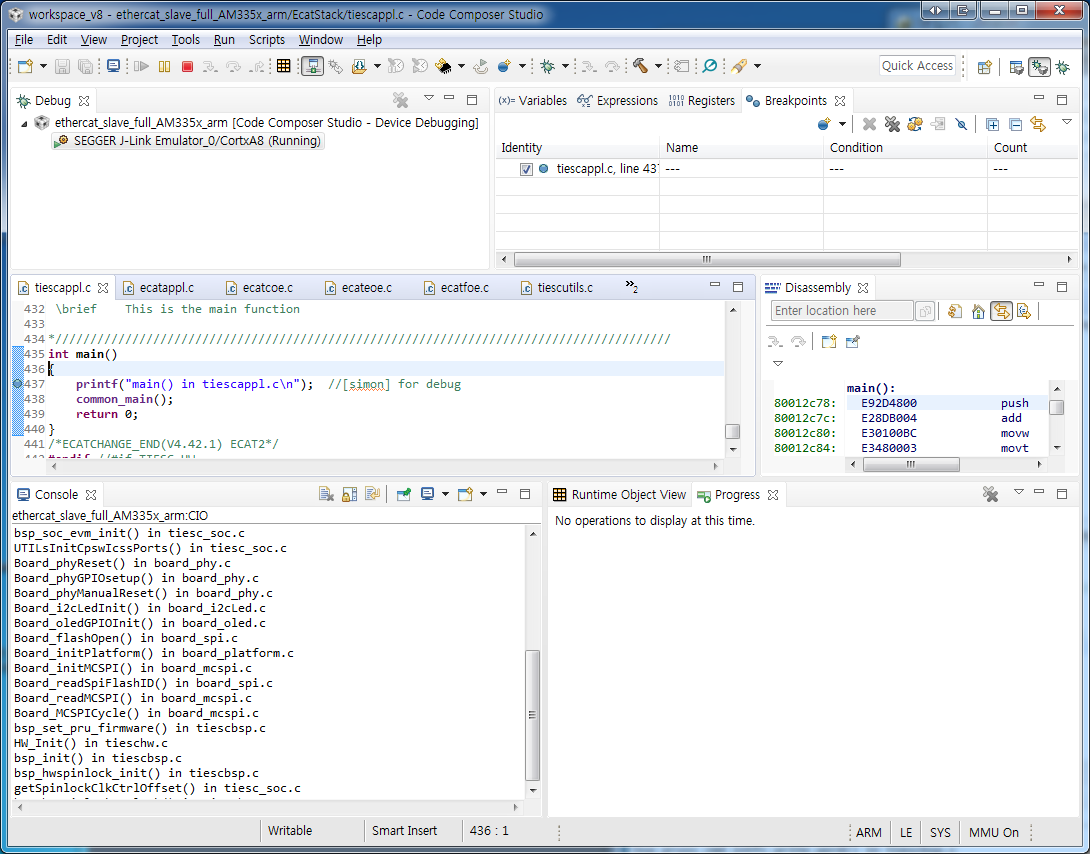

    Your program exits/aborts when running on my ICEv2 board. Please remove all printf/debug info and start from scratch with a new build. Ensure to use the recommended Processor SDK version.
    Garrett
  • Hi. Garrett.
    I upload the new ethercat_slave_full_AM335x_arm files built by CCS.
    In my environment, debugging normally runs.
    LCD display : "EtherCAT APP 1.0.7 / Rev 0190|Bld 04EE|"
    ti-processor-sdk-rtos-am335x-evm-05.01.00.11
    PRU-ICSS-EtherCAT_Slave_01.00.07.02
    SlaveStackCode : 5.12
    AM335x_debug.zip
    AM335x_release.zip
    Simon

  • Hi Simon, both of your *.out (from debug and release folders) works OK in my setup.
    My setup:
    - ICEv2 board, CCSv8.2, TwinCAT3.
    - Via JTAG (XDS100v2 - on board) I download and run ethercat_slave_full_AM335x_arm.out
    Results:
    - I was able to scan slave and to change LED values in OP state.
    Hope this helps,
