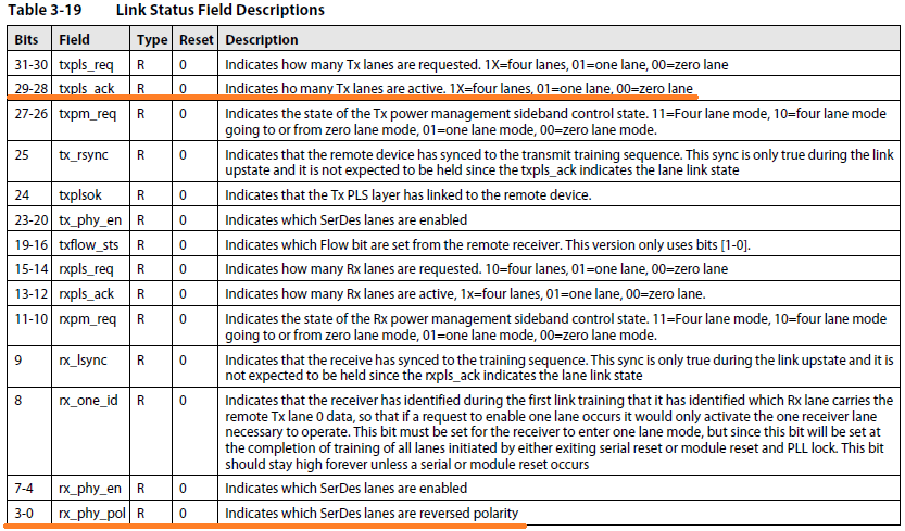

Here I got a problem when I enable Hyperlink, Mostly the Hyperlink can be enabled without error, but there is chance(about 1/150~200), it will find the following error status:
DSP1 hyperlink FAIL with link Status FDF00CF3, and ECC status: 0.
DSP2 hyperlink FAIL with link Status CCF0BDFB, and ECC status: 0.
While the correct status is:
DSP1 hyperlink successful with link Status FDF0BDFB, and ECC status: 0.
DSP2 hyperlink successful with link Status FDF0BDFB, and ECC status: 0.
As we can see, the error is due to the SerDes Lane plarity error which cause the link fail.
Since the Polarity is auto detect and set by Hyperlink module, may I know how can I handle the problem Or if there is an manual mode to set the polarity or not?

    4. How the C6678 physically connected via Hyperlink port? cable? Is that reliable? Do you have any polarity reversal in connection (why the working case FDF0BDFB showing 3 lanes polarity reversal)? And if lane 0, 1,2, 3 connected to the lane 0, 1,2,3 on the other side in the order?

    3. Actually only the lane 2(counter from 0) was inverted p and n at PCB board. and the Lane is 0->0 and 3->3. (As you can see the auto detect is inverting 0,1,3, and it works)

    The polarity is automatically detected and set by HW.
    Regards, Eric
