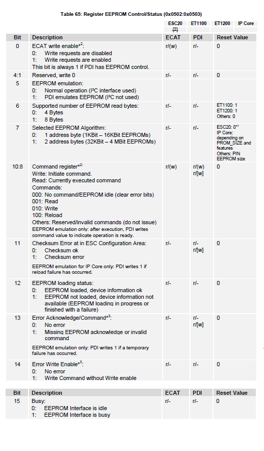

Hello everyone,
I have an Ethercat network which is composed by an Ethercat master with a real time Core Intime and a stack provided by KPA and 6 Ethercat slaves ARM3359.
The software in my Texas slave is base on the one provided by Texas with the Beckofff patch: ethercat_slave_full_AM335x_arm.pjt
I have a new problem since I have update my stack master server provided by KPA. I have updated my version of KPA with  MDK_INtime6_v1.6_December_2018
 In fact, with these versions, the transfer by FOE is not functioning anymore:
I try to transfert an update file:
  • In KPA Studio, I ask the Bootstrap Mode,
  • Then I try to transfer an update file by FOE and, at the moment on the transfer begins, all the network is broken.
If I make the same operation with another version of KPA (KPA MDK 1.5 x86 [INtime 6.x]-MDK_INtime6.2_v1.5_March_2017) everything is ok !
In fact, after contacting KPA, it seems that the problem comes from that in BOOTSTRAP Mode, at the beginning of FOE downloading, the master try to read the slave EEprom and in the BOOTSTRAP Mode it seems impossible to read the slave EEprom.
Is there anyone who can help me on this subject ?
