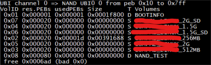

Hi all:
I have a UBI partition table in NAND flash (256MB). The BOOTINFO is at the top of the UBI table and the other 6 partitions are behind the BOOTINFO.
I also put bootload(IPL) in NAND flash too. It locates at the beginning of the NAND flash(0x00000000h).
After Linux launch on, I use "ubiattach" tool to make NAND flash accessible. I reboot again, I found I can launch on. And I found the bootloader was damaged.
I retry again, I found the bootloader will be okay if I didn't attach UBI partition.
Is that because the UBI partition and the bootloader were overlapped?
SDK ver. : J6_03_02_00_03

  • Hi Srirama Govindarajan:
    Thanks for your help.
    Here is my UBI table.
    My device tree
    And I did some research these few days. I found the root cause of this situation might be the device tree partition.
    Is that the device tree partition overlap the bootloader? Any suggestion?
    Thanks again.
    Jackie
  • Hi
    You can refer to the illustrative partition mapping table described in the device tree definition file for DRA72x - under arch/arm/boot/dts/dra72-evm-common.dtsi
    I have attached the snippet with the definition below for quick reference - you need to ensure your allocation matches with the table described in the device tree file
